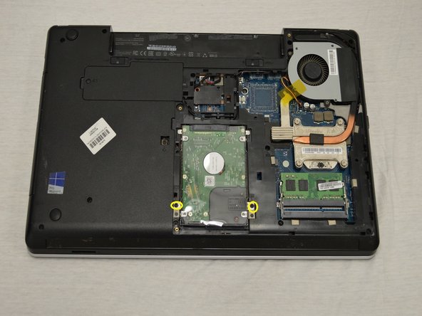

  7. Lenovo Thinkpad Edge E545 Hard Drive Replacement, Hard Drive: crwdns2935265:07crwdnd2935265:01crwdnd2935265:02crwdne2935265:0 Lenovo Thinkpad Edge E545 Hard Drive Replacement, Hard Drive: crwdns2935265:07crwdnd2935265:02crwdnd2935265:02crwdne2935265:0
    • After back panel is removed, you can remove the two screws at the bottom of the hard drive using the Phillips #000 screwdriver.
  8. Lenovo Thinkpad Edge E545 Hard Drive Replacement: crwdns2935265:08crwdnd2935265:01crwdnd2935265:01crwdne2935265:0
    • After screws are removed, slide the hard drive down to disconnect from motherboard and remove it.
  9. Lenovo Thinkpad Edge E545 Hard Drive Replacement: crwdns2935265:09crwdnd2935265:01crwdnd2935265:01crwdne2935265:0
    • Now you have successfully removed the Hard drive.
