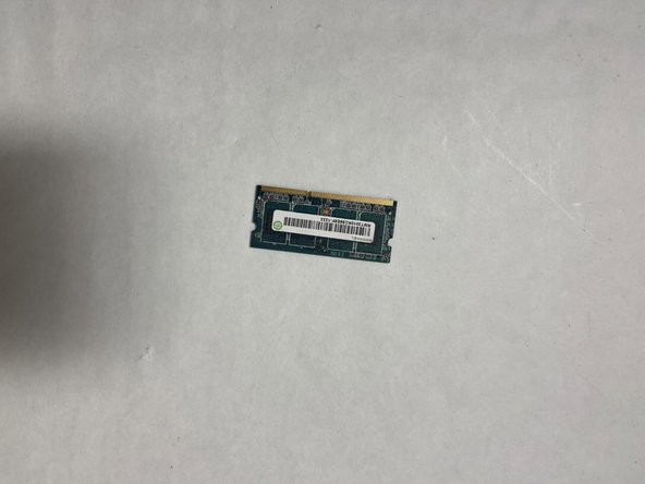

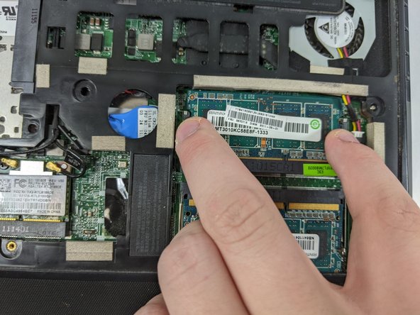

  3. Lenovo ThinkPad x120e RAM Replacement, RAM: crwdns2935265:03crwdnd2935265:01crwdnd2935265:03crwdne2935265:0 Lenovo ThinkPad x120e RAM Replacement, RAM: crwdns2935265:03crwdnd2935265:02crwdnd2935265:03crwdne2935265:0 Lenovo ThinkPad x120e RAM Replacement, RAM: crwdns2935265:03crwdnd2935265:03crwdnd2935265:03crwdne2935265:0
    Anti-Static Wrist Strap
    $7.95
    • Push the two mounting clips on either side of the RAM away from each other.
    • While doing this step, wear an anti-static wrist strap. This will prevent you from generating static that could damage the RAM module.
  4. Lenovo ThinkPad x120e RAM Replacement: crwdns2935265:04crwdnd2935265:01crwdnd2935265:02crwdne2935265:0 Lenovo ThinkPad x120e RAM Replacement: crwdns2935265:04crwdnd2935265:02crwdnd2935265:02crwdne2935265:0
    • The RAM should now be lifting up at an angle.
    • Slide the RAM stick out in the direction the angle is facing.
    • While installing the new RAM stick, push the stick down at an angle and make sure you secure it with the small clips at both sides.
