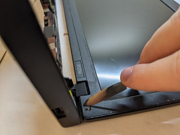

    • Remove the screw covers that are located on both sides of the display using a spudger.
    • Start from the corners of the screw covers to remove it more easily.

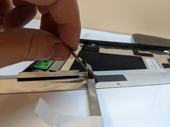

  13. Lenovo ThinkPad x120e LCD Screen Replacement: crwdns2935265:013crwdnd2935265:01crwdnd2935265:01crwdne2935265:0
    • At the base of the screen, there is a transparent tape holding a connector. Peel the tape off.
  14. Lenovo ThinkPad x120e LCD Screen Replacement: crwdns2935265:014crwdnd2935265:01crwdnd2935265:01crwdne2935265:0
    • Remove the connector underneath where the tape was using a spudger tool.
    • Pull out the connector.
    • Make sure to not damage any of the wires.
  15. Lenovo ThinkPad x120e LCD Screen Replacement: crwdns2935265:015crwdnd2935265:01crwdnd2935265:01crwdne2935265:0
    • Remove the gray tape fully.
    • Flip over the device, and remove the LCD screen fully.
