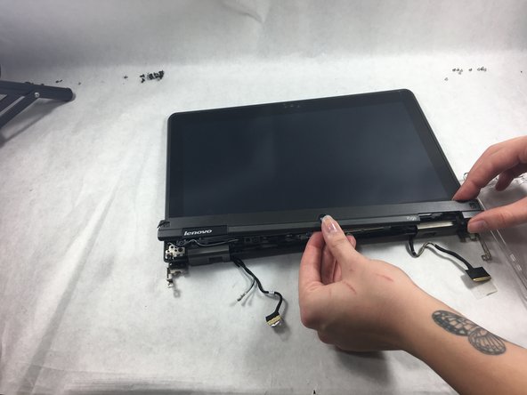

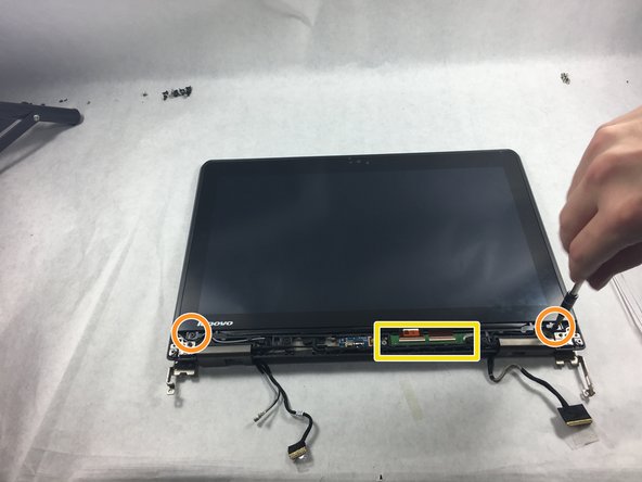

    1. Lenovo ThinkPad Yoga Screen Replacement, Screen: crwdns2935265:03crwdnd2935265:01crwdnd2935265:03crwdne2935265:0 Lenovo ThinkPad Yoga Screen Replacement, Screen: crwdns2935265:03crwdnd2935265:02crwdnd2935265:03crwdne2935265:0 Lenovo ThinkPad Yoga Screen Replacement, Screen: crwdns2935265:03crwdnd2935265:03crwdnd2935265:03crwdne2935265:0
      • Remove two screws under the plastic covers on the front of the screen using a Phillips #0 screwdriver.
      • Pry the plastic cover off with a spudger.
      • Remove the two screws from underneath the cover using a Phillips #0 screwdriver.
      • Detach the screen connector from the rest of the laptop.
    2. Lenovo ThinkPad Yoga Screen Replacement: crwdns2935265:04crwdnd2935265:01crwdnd2935265:01crwdne2935265:0
      • Remove the screen from the rest of the laptop.
