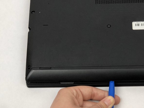

  3. Lenovo ThinkPad Yoga 370 Touchpad Replacement: crwdns2935265:03crwdnd2935265:01crwdnd2935265:02crwdne2935265:0 Lenovo ThinkPad Yoga 370 Touchpad Replacement: crwdns2935265:03crwdnd2935265:02crwdnd2935265:02crwdne2935265:0
    • Note that while the screws are undone, the bottom cover is still attached by several plastic clips around the edges.
    • Using the plastic opening tool, work around the edges of the bottom cover to undo the plastic clips.
  4. Lenovo ThinkPad Yoga 370 Touchpad Replacement: crwdns2935265:04crwdnd2935265:01crwdnd2935265:02crwdne2935265:0 Lenovo ThinkPad Yoga 370 Touchpad Replacement: crwdns2935265:04crwdnd2935265:02crwdnd2935265:02crwdne2935265:0
    • Gently remove the cover by placing your fingers around the edges.

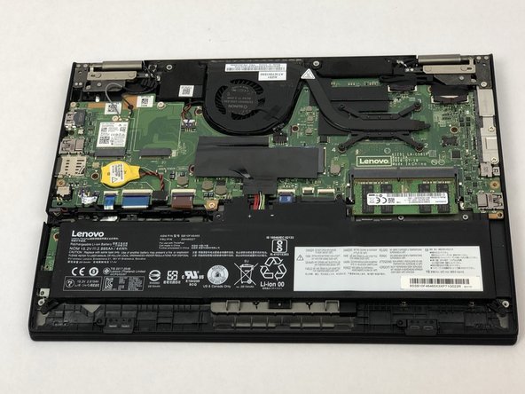

  5. Lenovo ThinkPad Yoga 370 Touchpad Replacement: crwdns2935265:05crwdnd2935265:01crwdnd2935265:03crwdne2935265:0 Lenovo ThinkPad Yoga 370 Touchpad Replacement: crwdns2935265:05crwdnd2935265:02crwdnd2935265:03crwdne2935265:0 Lenovo ThinkPad Yoga 370 Touchpad Replacement: crwdns2935265:05crwdnd2935265:03crwdnd2935265:03crwdne2935265:0
    • With your fingers, fold back the plastic cover highlighted.
    • Using two fingers, gently remove the battery connectors.
  6. Lenovo ThinkPad Yoga 370 Touchpad Replacement: crwdns2935265:06crwdnd2935265:01crwdnd2935265:03crwdne2935265:0 Lenovo ThinkPad Yoga 370 Touchpad Replacement: crwdns2935265:06crwdnd2935265:02crwdnd2935265:03crwdne2935265:0 Lenovo ThinkPad Yoga 370 Touchpad Replacement: crwdns2935265:06crwdnd2935265:03crwdnd2935265:03crwdne2935265:0
    • Using the Phillips #00 screwdriver, remove the two 4mm screws.
    • Remove the battery.

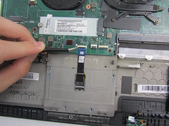

  7. Lenovo ThinkPad Yoga 370 Touchpad Replacement: crwdns2935265:07crwdnd2935265:01crwdnd2935265:02crwdne2935265:0 Lenovo ThinkPad Yoga 370 Touchpad Replacement: crwdns2935265:07crwdnd2935265:02crwdnd2935265:02crwdne2935265:0
    • Using the Phillips #00 screwdriver, remove the four 4mm screws.
    • Using tweezers or your fingers, gently undo the connection between the touchpad and the motherboard.
  8. Lenovo ThinkPad Yoga 370 Touchpad Replacement: crwdns2935265:08crwdnd2935265:01crwdnd2935265:01crwdne2935265:0
    • Turn the device over to the front side.
    • Using a plastic opening tool, gently remove the touchpad.
