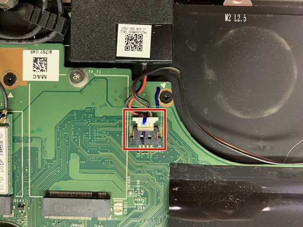

    • Using your index fingers, gently remove the fan’s power connection.

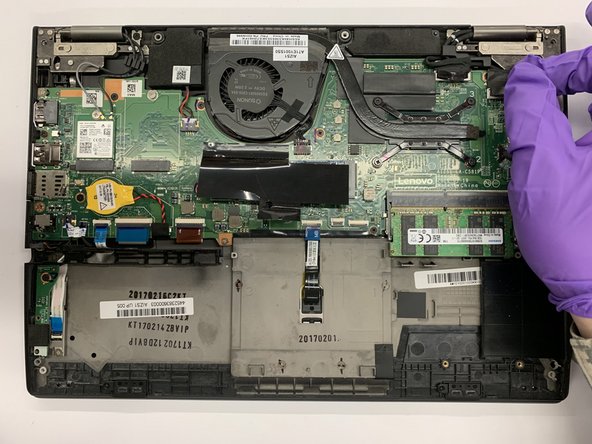

  15. Lenovo ThinkPad Yoga 260 Motherboard Replacement, Motherboard: crwdns2935265:015crwdnd2935265:01crwdnd2935265:02crwdne2935265:0 Lenovo ThinkPad Yoga 260 Motherboard Replacement, Motherboard: crwdns2935265:015crwdnd2935265:02crwdnd2935265:02crwdne2935265:0
    • Disconnect the speaker cable located near hinge side of the laptop.
    • Remove both speakers from the assembly.
  16. Lenovo ThinkPad Yoga 260 Motherboard Replacement: crwdns2935265:016crwdnd2935265:01crwdnd2935265:03crwdne2935265:0 Lenovo ThinkPad Yoga 260 Motherboard Replacement: crwdns2935265:016crwdnd2935265:02crwdnd2935265:03crwdne2935265:0 Lenovo ThinkPad Yoga 260 Motherboard Replacement: crwdns2935265:016crwdnd2935265:03crwdnd2935265:03crwdne2935265:0

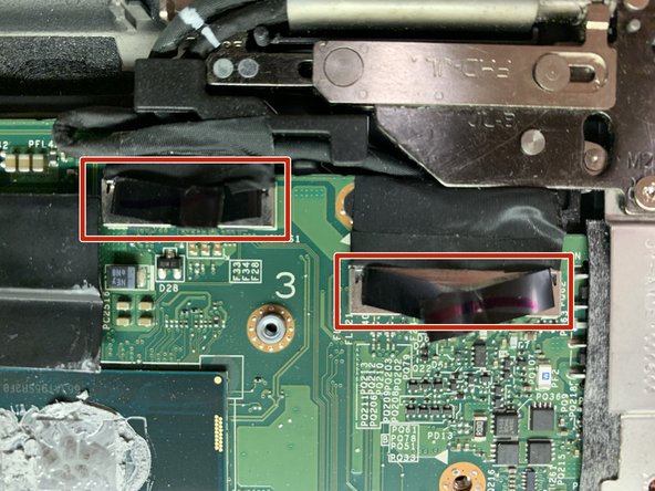

    • Pull up on the 2 black tabs to remove the cords located along the hinge edge of the device.
  18. Lenovo ThinkPad Yoga 260 Motherboard Replacement: crwdns2935265:018crwdnd2935265:01crwdnd2935265:03crwdne2935265:0 Lenovo ThinkPad Yoga 260 Motherboard Replacement: crwdns2935265:018crwdnd2935265:02crwdnd2935265:03crwdne2935265:0 Lenovo ThinkPad Yoga 260 Motherboard Replacement: crwdns2935265:018crwdnd2935265:03crwdnd2935265:03crwdne2935265:0
    • Pull up the 6 colored tabs along the edge of the motherboard to disconnect them from the motherboard.
