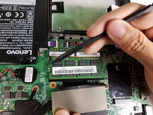

  4. Lenovo ThinkPad Yoga 14 20FY RAM Replacement: crwdns2935265:04crwdnd2935265:01crwdnd2935265:03crwdne2935265:0 Lenovo ThinkPad Yoga 14 20FY RAM Replacement: crwdns2935265:04crwdnd2935265:02crwdnd2935265:03crwdne2935265:0 Lenovo ThinkPad Yoga 14 20FY RAM Replacement: crwdns2935265:04crwdnd2935265:03crwdnd2935265:03crwdne2935265:0
    • The RAM is held in place by two metal pieces on both sides.
    • Use the spudger to push off both metal pieces to release the RAM.
  5. Lenovo ThinkPad Yoga 14 20FY RAM Replacement: crwdns2935265:05crwdnd2935265:01crwdnd2935265:01crwdne2935265:0
    • Take the ram card out of its slot.
