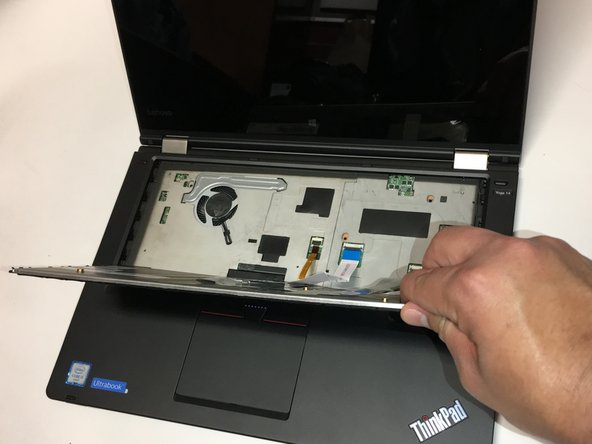

    • Flip the laptop back over and open it normally.
    • Use a plastic opening tool to lift up the keyboard along the bottom edge until it is detached.
  3. Lenovo ThinkPad Yoga 14 20FY Keyboard Replacement: crwdns2935265:03crwdnd2935265:01crwdnd2935265:02crwdne2935265:0 Lenovo ThinkPad Yoga 14 20FY Keyboard Replacement: crwdns2935265:03crwdnd2935265:02crwdnd2935265:02crwdne2935265:0
    • Using a finger, push the top of the keyboard out of its holder to completely detach it.
    • Move the keyboard out of the way by rotating the far side of the keyboard towards you.

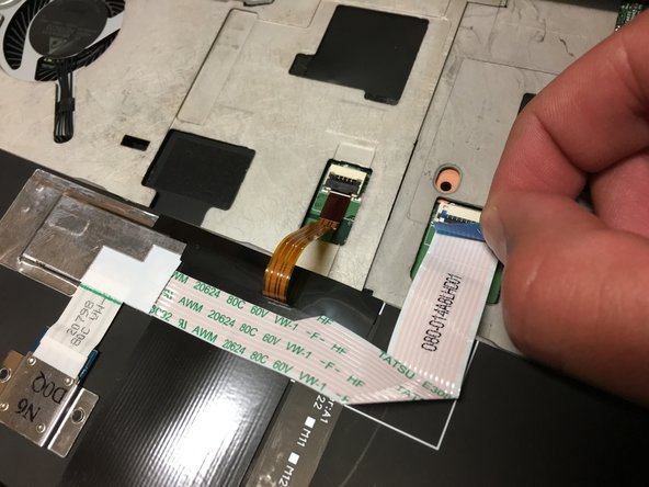

  4. Lenovo ThinkPad Yoga 14 20FY Keyboard Replacement: crwdns2935265:04crwdnd2935265:01crwdnd2935265:02crwdne2935265:0 Lenovo ThinkPad Yoga 14 20FY Keyboard Replacement: crwdns2935265:04crwdnd2935265:02crwdnd2935265:02crwdne2935265:0
    • Be gentle! These connectors are very small and can easily break off.
    • Lay the keyboard on its front.
    • Disconnect the 3 cables by pulling on the attached tabs.
