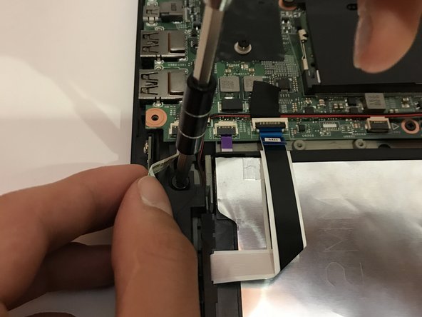

    • Once the back cover is exposed, remove the two screws holding the hard drive in place.
  4. Lenovo ThinkPad Yoga 14 20FY Hard Drive  Replacement: crwdns2935265:04crwdnd2935265:01crwdnd2935265:01crwdne2935265:0
    • Remove the plastic encasing holding down the hard drive after screws are removed.
    • This is the plastic encasing covering the SATA connection on the hard drive. There will be another plastic encasing that will be required to remove in a later step.

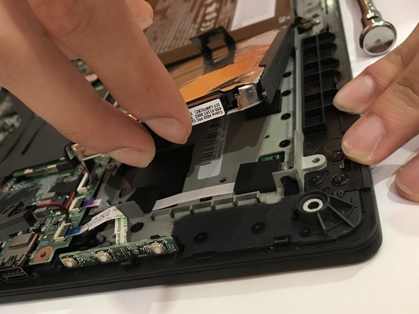

  5. Lenovo ThinkPad Yoga 14 20FY Hard Drive  Replacement: crwdns2935265:05crwdnd2935265:01crwdnd2935265:02crwdne2935265:0 Lenovo ThinkPad Yoga 14 20FY Hard Drive  Replacement: crwdns2935265:05crwdnd2935265:02crwdnd2935265:02crwdne2935265:0
    • Using two fingers, carefully remove the hard drive.

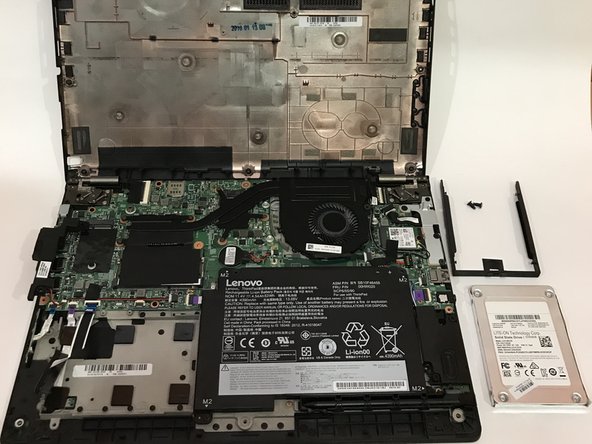

  6. Lenovo ThinkPad Yoga 14 20FY Hard Drive  Replacement: crwdns2935265:06crwdnd2935265:01crwdnd2935265:02crwdne2935265:0 Lenovo ThinkPad Yoga 14 20FY Hard Drive  Replacement: crwdns2935265:06crwdnd2935265:02crwdnd2935265:02crwdne2935265:0
    • Carefully remove the plastic encasing surrounding the perimeter of the hard drive.

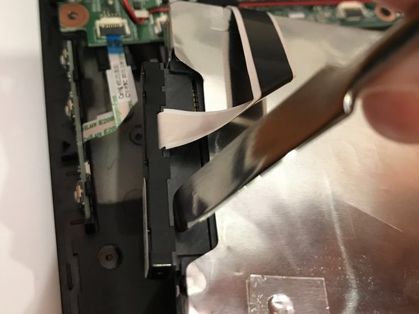

  7. Lenovo ThinkPad Yoga 14 20FY Hard Drive  Replacement: crwdns2935265:07crwdnd2935265:01crwdnd2935265:03crwdne2935265:0 Lenovo ThinkPad Yoga 14 20FY Hard Drive  Replacement: crwdns2935265:07crwdnd2935265:02crwdnd2935265:03crwdne2935265:0 Lenovo ThinkPad Yoga 14 20FY Hard Drive  Replacement: crwdns2935265:07crwdnd2935265:03crwdnd2935265:03crwdne2935265:0
    • This step requires the most precision. Forcefully using the prying tool to remove the SATA connector may damage the hard drive and the connection. Remove the connection slowly to a point where you can safely finish removing the connection with your fingers.
    • Use a nylon spudger to remove the SATA connector from the hard drive.

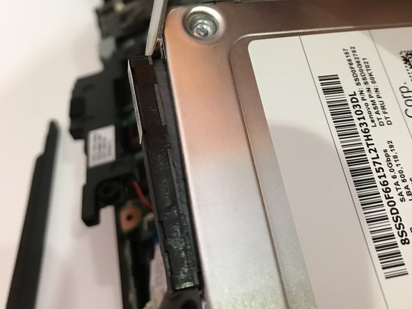

  8. Lenovo ThinkPad Yoga 14 20FY Hard Drive  Replacement: crwdns2935265:08crwdnd2935265:01crwdnd2935265:02crwdne2935265:0 Lenovo ThinkPad Yoga 14 20FY Hard Drive  Replacement: crwdns2935265:08crwdnd2935265:02crwdnd2935265:02crwdne2935265:0
    • After the SATA connection is removed, gently pop off the hard drive from its socket.
