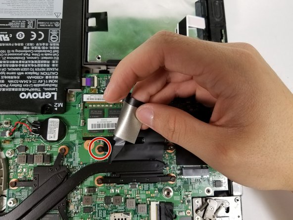

    • Remove all 7 screws.
    • One of the screws is behind a black piece of the plastic.

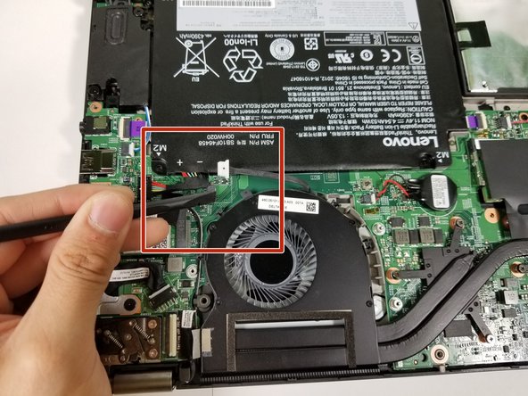

    • Use the flat end of the spudger to push the connector out of its socket .
    • Do not use the wire to pull the connector out!
  5. Lenovo ThinkPad Yoga 14 20FY  Fan  Replacement: crwdns2935265:05crwdnd2935265:01crwdnd2935265:02crwdne2935265:0 Lenovo ThinkPad Yoga 14 20FY  Fan  Replacement: crwdns2935265:05crwdnd2935265:02crwdnd2935265:02crwdne2935265:0
    • There is a wire looped around the fan. Use the spudger to pull the wires out of the loop.

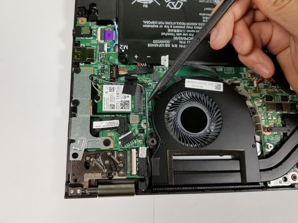

  6. Lenovo ThinkPad Yoga 14 20FY  Fan  Replacement: crwdns2935265:06crwdnd2935265:01crwdnd2935265:01crwdne2935265:0
    • Gently peel back a piece of tape in the bottom left corner of the fan.
  7. Lenovo ThinkPad Yoga 14 20FY  Fan  Replacement: crwdns2935265:07crwdnd2935265:01crwdnd2935265:01crwdne2935265:0
    • Gently lift out the fan.
