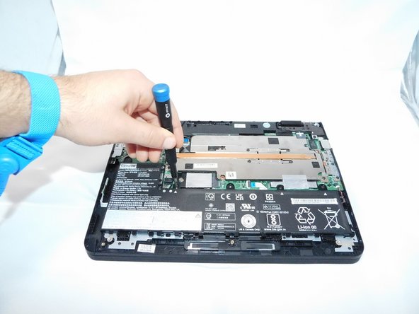

    • Remove the screws holding the battery in place. There are 5 screws that need to be removed.
    • Using the same screwdriver and bit as before, remove all the screws and keep them somewhere safe.

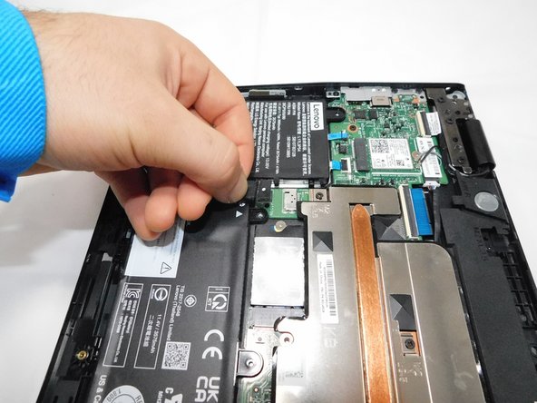

    • Remove the battery
    • The battery is latched on so it will require some force to pop it out.
