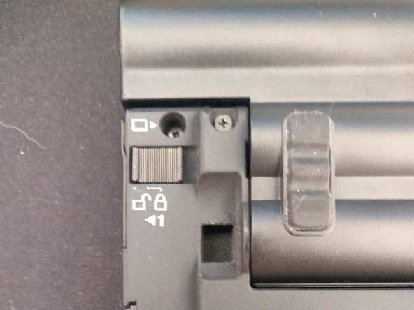

    • Lay the laptop on it´s front cover so that you are facing the back cover.
  2. Lenovo ThinkPad X61 Battery Replacement: crwdns2935265:02crwdnd2935265:01crwdnd2935265:02crwdne2935265:0 Lenovo ThinkPad X61 Battery Replacement: crwdns2935265:02crwdnd2935265:02crwdnd2935265:02crwdne2935265:0

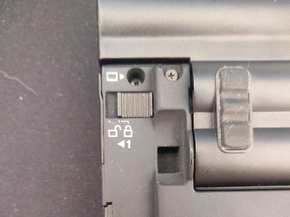

    • Unlock battery mechanism on the top left corner.
  3. Lenovo ThinkPad X61 Battery Replacement: crwdns2935265:03crwdnd2935265:01crwdnd2935265:02crwdne2935265:0 Lenovo ThinkPad X61 Battery Replacement: crwdns2935265:03crwdnd2935265:02crwdnd2935265:02crwdne2935265:0
    • Pull the second battery mechanism with your right hand. Keep doing it while you slide upwards the battery with your left hand.
