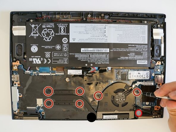

    • Loosen the seven screws surrounding the fan and heatsink using the Phillips #1 screwdriver.
