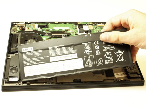

    • Using a Phillips #0 screwdriver, remove the four 5.2 mm screws holding the battery in place.
  5. Lenovo ThinkPad X390 Touchpad Replacement: crwdns2935265:05crwdnd2935265:01crwdnd2935265:02crwdne2935265:0 Lenovo ThinkPad X390 Touchpad Replacement: crwdns2935265:05crwdnd2935265:02crwdnd2935265:02crwdne2935265:0
    • Using your hands, remove the battery from the laptop.
