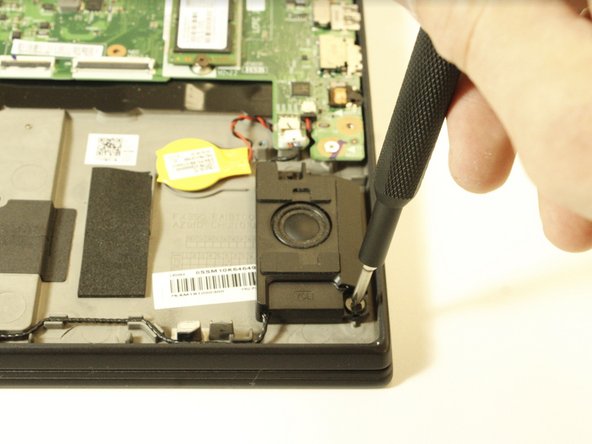

  6. Lenovo ThinkPad X390 Speaker Replacement, Speaker: crwdns2935265:06crwdnd2935265:01crwdnd2935265:01crwdne2935265:0
    • Using a pair of tweezers, unplug the speakers from the motherboard.
  7. Lenovo ThinkPad X390 Speaker Replacement: crwdns2935265:07crwdnd2935265:01crwdnd2935265:02crwdne2935265:0 Lenovo ThinkPad X390 Speaker Replacement: crwdns2935265:07crwdnd2935265:02crwdnd2935265:02crwdne2935265:0
    • Use the Phillips #0 screwdriver to remove four 2.9 mm screws securing the speakers to the motherboard.
  8. Lenovo ThinkPad X390 Speaker Replacement: crwdns2935265:08crwdnd2935265:01crwdnd2935265:01crwdne2935265:0
    • Carefully unwind the speakers from the motherboard and remove them from the device.
