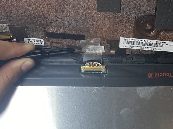

    • Lay the computer flat on the back of the screen.
  2. Lenovo ThinkPad X280 Display Assembly: crwdns2935265:02crwdnd2935265:01crwdnd2935265:01crwdne2935265:0
    • Use the metal spudger to pry the screen away from the assembly.
  3. Lenovo ThinkPad X280 Display Assembly: crwdns2935265:03crwdnd2935265:01crwdnd2935265:01crwdne2935265:0
    • The screen will fold down over the keyboard, exposing the connections.
  4. Lenovo ThinkPad X280 Display Assembly: crwdns2935265:04crwdnd2935265:01crwdnd2935265:02crwdne2935265:0 Lenovo ThinkPad X280 Display Assembly: crwdns2935265:04crwdnd2935265:02crwdnd2935265:02crwdne2935265:0
    • Use tweezers to gently remove the tape that secures the connector.
    • Lift the bracket on the bottom of the connector, and gently remove the bundled cable.
  5. Lenovo ThinkPad X280 Display Assembly: crwdns2935265:05crwdnd2935265:01crwdnd2935265:01crwdne2935265:0
    • Remove the screen.

Anyone tried modding the screen with a 13.3" screen? I heard the screen part number is N133HCE-GP1, but you need to cut the bezels, and rewire the camera module and stuff.
