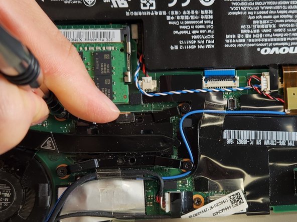

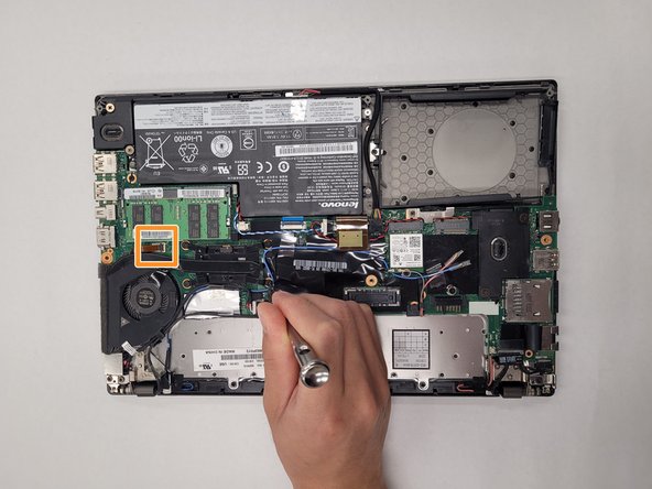

  5. Lenovo ThinkPad X260 Cooling Fan Replacement, Cooling Fan: crwdns2935265:05crwdnd2935265:01crwdnd2935265:02crwdne2935265:0 Lenovo ThinkPad X260 Cooling Fan Replacement, Cooling Fan: crwdns2935265:05crwdnd2935265:02crwdnd2935265:02crwdne2935265:0
    • Remove the four 2.9 mm screws that hold the cooling fan in order of 4, 3, 2, 1 using a Phillips #1 screwdriver.
    • Gently lift the plastic retaining flap to disconnect the ribbon cable.
    • The plastic that holds the ribbon wire in place is a black lever on a tan block.
  6. Lenovo ThinkPad X260 Cooling Fan Replacement: crwdns2935265:06crwdnd2935265:01crwdnd2935265:02crwdne2935265:0 Lenovo ThinkPad X260 Cooling Fan Replacement: crwdns2935265:06crwdnd2935265:02crwdnd2935265:02crwdne2935265:0
    • Gently remove the wires which run along the fan.
    • Remove the old cooling fan.

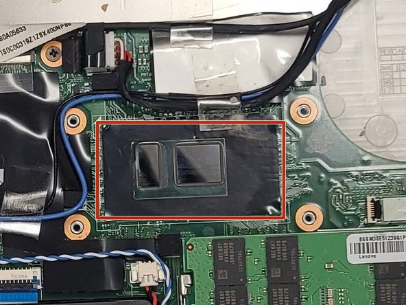

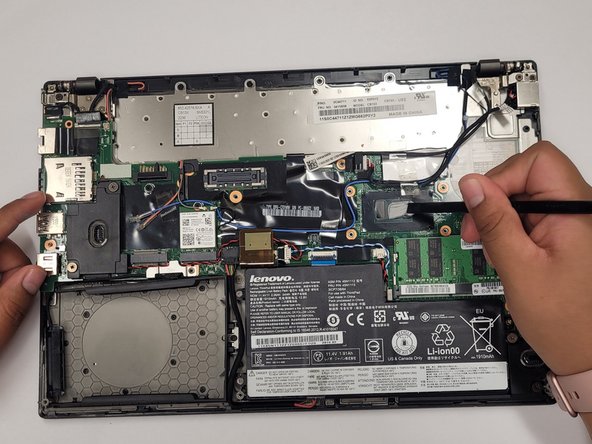

  7. Lenovo ThinkPad X260 Cooling Fan Replacement: crwdns2935265:07crwdnd2935265:01crwdnd2935265:02crwdne2935265:0 Lenovo ThinkPad X260 Cooling Fan Replacement: crwdns2935265:07crwdnd2935265:02crwdnd2935265:02crwdne2935265:0
    • Clean the old thermal paste off of the CPU.
    • The CPU, when clean, should have a glossy black finish.
  8. Lenovo ThinkPad X260 Cooling Fan Replacement: crwdns2935265:08crwdnd2935265:01crwdnd2935265:03crwdne2935265:0 Lenovo ThinkPad X260 Cooling Fan Replacement: crwdns2935265:08crwdnd2935265:02crwdnd2935265:03crwdne2935265:0 Lenovo ThinkPad X260 Cooling Fan Replacement: crwdns2935265:08crwdnd2935265:03crwdnd2935265:03crwdne2935265:0
    • Apply new thermal paste to the CPU.
    • Place the new fan in position and secure by reatching the screws in the order of 1, 2, 3, 4.
