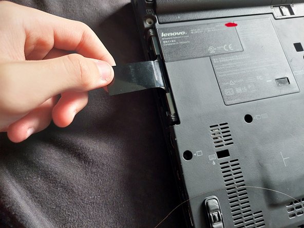

  4. Lenovo ThinkPad X201 Hard Drive Replacement, Cool, now let's pull the drive mount out: crwdns2935265:04crwdnd2935265:01crwdnd2935265:02crwdne2935265:0 Lenovo ThinkPad X201 Hard Drive Replacement, Cool, now let's pull the drive mount out: crwdns2935265:04crwdnd2935265:02crwdnd2935265:02crwdne2935265:0
    • Pull out the hard drive compartment door
    • Cool. Now use your fingers to unfold the black plastic pull tab and pull the drive out.

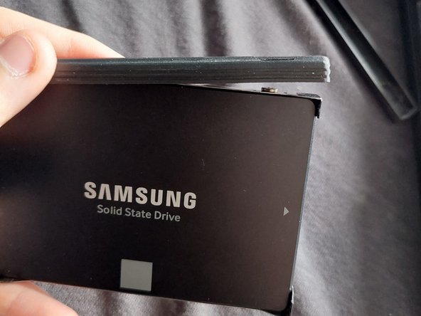

  5. Lenovo ThinkPad X201 Hard Drive Replacement, Unscrewing the drive from the bracket: crwdns2935265:05crwdnd2935265:01crwdnd2935265:02crwdne2935265:0 Lenovo ThinkPad X201 Hard Drive Replacement, Unscrewing the drive from the bracket: crwdns2935265:05crwdnd2935265:02crwdnd2935265:02crwdne2935265:0
    • Use your #0 Phillips screwdriver and remove the 4 screws from the hard drive bracket, two on each side.
    • Now, pull the hard drive out of the bracket with your fingers. Make sure not to stress the SATA connectors on the bottom side of the drive.
  6. Lenovo ThinkPad X201 Hard Drive Replacement, Put a new drive in the bracket: crwdns2935265:06crwdnd2935265:01crwdnd2935265:03crwdne2935265:0 Lenovo ThinkPad X201 Hard Drive Replacement, Put a new drive in the bracket: crwdns2935265:06crwdnd2935265:02crwdnd2935265:03crwdne2935265:0 Lenovo ThinkPad X201 Hard Drive Replacement, Put a new drive in the bracket: crwdns2935265:06crwdnd2935265:03crwdnd2935265:03crwdne2935265:0
    • Get your new drive, and just put it in. Make sure the SATA ports face the end of the bracket that does not have the pull tab, and that the L-shaped connectors have their short side pointing down towards the metal plate.
    • Screw the four screws back in, and put the protective rubber back on the sides of the bracket.
    • Flip the drive upside down, with the gold contacts facing towards you and gently put it back in the drive slot.
    • Make sure that the pull tab is facing away from the laptop.
