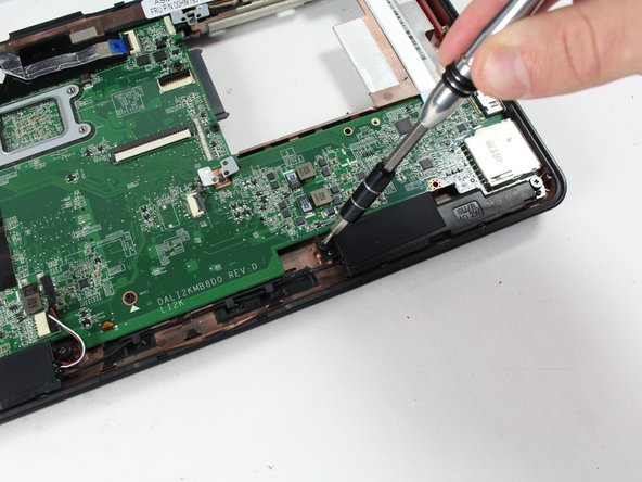

    • The speakers are located on the bottom of the laptop, where the mouse pad is located.
    • Remove the four 4.5 mm Phillips #0 screws on either side of both speakers.

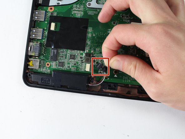

    • Remove the cable that is attached from the speakers to the board.

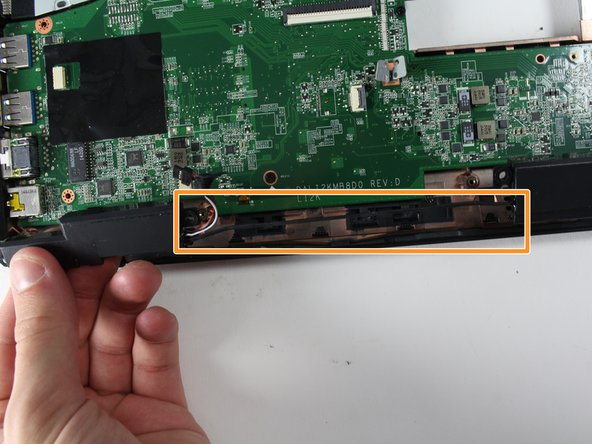

    • Unhook the black wire that connects the speaker on the left to the speaker on the right.
    • After unhooking the wire, simply pull the speakers out of the laptop.
