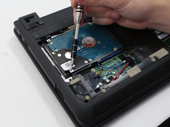

  4. Lenovo ThinkPad X140e Hard Drive Replacement, Hard Drive: crwdns2935265:04crwdnd2935265:01crwdnd2935265:01crwdne2935265:0
    • After removing the back panel, locate the hard drive located to the far left. It is distinguishable from other parts based on it's rectangular shape.
  5. Lenovo ThinkPad X140e Hard Drive Replacement: crwdns2935265:05crwdnd2935265:01crwdnd2935265:02crwdne2935265:0 Lenovo ThinkPad X140e Hard Drive Replacement: crwdns2935265:05crwdnd2935265:02crwdnd2935265:02crwdne2935265:0
    • Remove the four 3.5 mm Phillips #0 screws attached on the four corners of the hard drive.
  6. Lenovo ThinkPad X140e Hard Drive Replacement: crwdns2935265:06crwdnd2935265:01crwdnd2935265:02crwdne2935265:0 Lenovo ThinkPad X140e Hard Drive Replacement: crwdns2935265:06crwdnd2935265:02crwdnd2935265:02crwdne2935265:0
    • Slide the hard drive to the left.
    • Grip the hard drive on both sides and proceed to lift up to remove the hard drive.
