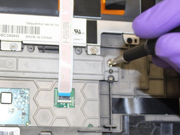

  7. Lenovo ThinkPad X1 Yoga Trackpad Replacement, Trackpad: crwdns2935265:07crwdnd2935265:01crwdnd2935265:02crwdne2935265:0 Lenovo ThinkPad X1 Yoga Trackpad Replacement, Trackpad: crwdns2935265:07crwdnd2935265:02crwdnd2935265:02crwdne2935265:0
    • Using the Phillips #1 screwdriver, remove four 4.5 mm screws from the trackpad.

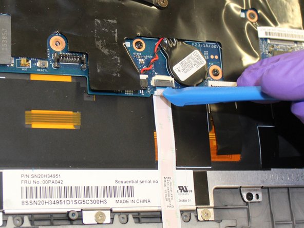

  8. Lenovo ThinkPad X1 Yoga Trackpad Replacement: crwdns2935265:08crwdnd2935265:01crwdnd2935265:02crwdne2935265:0 Lenovo ThinkPad X1 Yoga Trackpad Replacement: crwdns2935265:08crwdnd2935265:02crwdnd2935265:02crwdne2935265:0
    • Using the iFixit opening tool, flip up the small covers to the track pad cable connectors.
    • Gently pull the cable out of place.

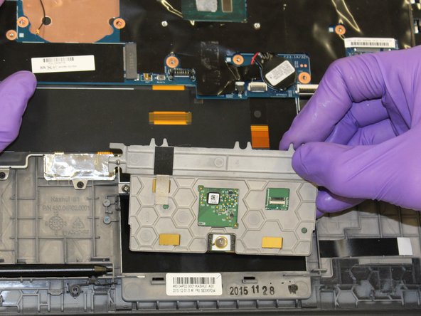

  9. Lenovo ThinkPad X1 Yoga Trackpad Replacement: crwdns2935265:09crwdnd2935265:01crwdnd2935265:02crwdne2935265:0 Lenovo ThinkPad X1 Yoga Trackpad Replacement: crwdns2935265:09crwdnd2935265:02crwdnd2935265:02crwdne2935265:0
    • Using iFixit opening tools, lift up the frame of the track pad.
    • Gently remove the track pad away from the computer.
