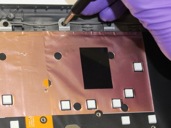

  19. Lenovo ThinkPad X1 Yoga Keyboard Replacement, Keyboard: crwdns2935265:019crwdnd2935265:01crwdnd2935265:02crwdne2935265:0 Lenovo ThinkPad X1 Yoga Keyboard Replacement, Keyboard: crwdns2935265:019crwdnd2935265:02crwdnd2935265:02crwdne2935265:0
    • Using the Phillips #1 screwdriver, remove 23 (twenty three) 4.5mm screws.
  20. Lenovo ThinkPad X1 Yoga Keyboard Replacement: crwdns2935265:020crwdnd2935265:01crwdnd2935265:01crwdne2935265:0
    • Using the iFixit opening tool, lift the metal frame away from the keyboard.
  21. Lenovo ThinkPad X1 Yoga Keyboard Replacement: crwdns2935265:021crwdnd2935265:01crwdnd2935265:01crwdne2935265:0
    • Lift and remove the keyboard away from the computer.
