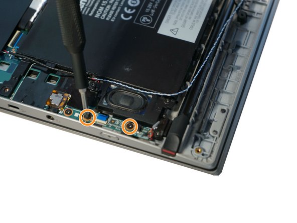

    • Disconnect the red and black charger wire from the port on the circuit board.
    • Remove two 4 mm screws using the Phillips #0 screwdriver.
  7. Lenovo ThinkPad X1 Yoga 2nd Generation Pen Charging Port Replacement: crwdns2935265:07crwdnd2935265:01crwdnd2935265:01crwdne2935265:0
    • Remove the circuit board by hand.
  8. Lenovo ThinkPad X1 Yoga 2nd Generation Pen Charging Port Replacement: crwdns2935265:08crwdnd2935265:01crwdnd2935265:02crwdne2935265:0 Lenovo ThinkPad X1 Yoga 2nd Generation Pen Charging Port Replacement: crwdns2935265:08crwdnd2935265:02crwdnd2935265:02crwdne2935265:0
    • Remove a single 6 mm screw from the charging port using the Phillips #0 screwdriver.
    • Remove the black charging port using your fingers.
