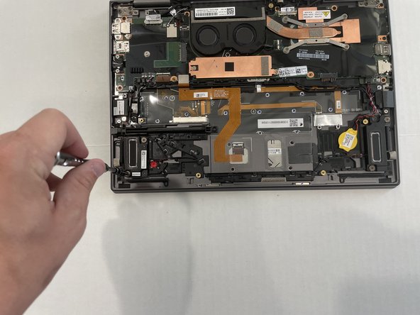

  5. Lenovo ThinkPad X1 Yoga (6th Gen) Motherboard Replacement, Speaker: crwdns2935265:05crwdnd2935265:01crwdnd2935265:03crwdne2935265:0 Lenovo ThinkPad X1 Yoga (6th Gen) Motherboard Replacement, Speaker: crwdns2935265:05crwdnd2935265:02crwdnd2935265:03crwdne2935265:0 Lenovo ThinkPad X1 Yoga (6th Gen) Motherboard Replacement, Speaker: crwdns2935265:05crwdnd2935265:03crwdnd2935265:03crwdne2935265:0
    • Use a Phillips #1 screwdriver to remove the four 1.8 mm screws.
  6. Lenovo ThinkPad X1 Yoga (6th Gen) Motherboard Replacement: crwdns2935265:06crwdnd2935265:01crwdnd2935265:03crwdne2935265:0 Lenovo ThinkPad X1 Yoga (6th Gen) Motherboard Replacement: crwdns2935265:06crwdnd2935265:02crwdnd2935265:03crwdne2935265:0 Lenovo ThinkPad X1 Yoga (6th Gen) Motherboard Replacement: crwdns2935265:06crwdnd2935265:03crwdnd2935265:03crwdne2935265:0

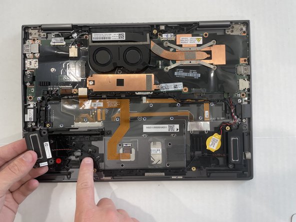

    • Use the spudger to lift the flap covering the speaker wire.
    • Starting at the top of the right speaker, follow the wire connected to the top of the left speaker. Use the tip of a spudger to free the wire from the plastic brackets it lies under.
    • Starting from near the bottom-left side of the right speaker, follow the lower wire, unseating the speaker cable as you go.
  7. Lenovo ThinkPad X1 Yoga (6th Gen) Motherboard Replacement: crwdns2935265:07crwdnd2935265:01crwdnd2935265:03crwdne2935265:0 Lenovo ThinkPad X1 Yoga (6th Gen) Motherboard Replacement: crwdns2935265:07crwdnd2935265:02crwdnd2935265:03crwdne2935265:0 Lenovo ThinkPad X1 Yoga (6th Gen) Motherboard Replacement: crwdns2935265:07crwdnd2935265:03crwdnd2935265:03crwdne2935265:0
    • Place your fingernails behind each of the plastic tabs on the speaker's plug and pull directly backwards until the plug releases from its port.
    • Lift the speakers up and out.
