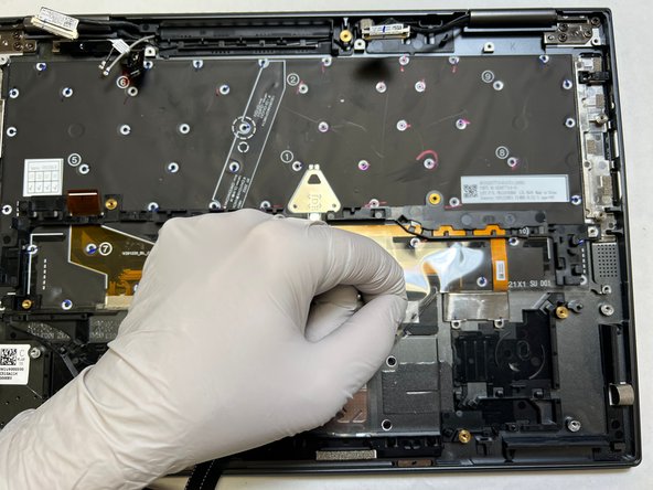

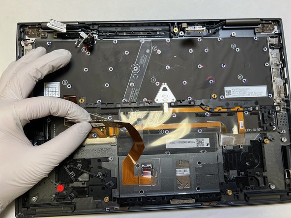

  17. Lenovo ThinkPad X1 Yoga (6th Gen) Keyboard and Touchpad Assembly Replacement: crwdns2935265:017crwdnd2935265:01crwdnd2935265:03crwdne2935265:0 Lenovo ThinkPad X1 Yoga (6th Gen) Keyboard and Touchpad Assembly Replacement: crwdns2935265:017crwdnd2935265:02crwdnd2935265:03crwdne2935265:0 Lenovo ThinkPad X1 Yoga (6th Gen) Keyboard and Touchpad Assembly Replacement: crwdns2935265:017crwdnd2935265:03crwdnd2935265:03crwdne2935265:0
    • Use a spudger to get under the connector ribbon and peel it off of the plastic covering.
    • Use a spudger to get under the clear plastic and peel it off of the keyboard and trackpad.

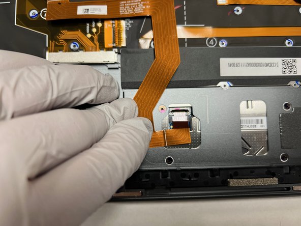

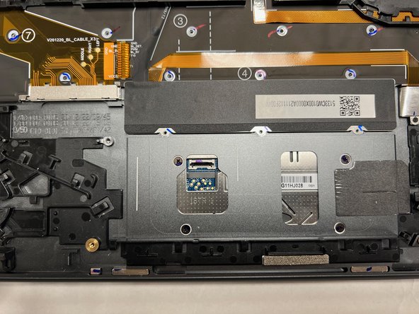

  18. Lenovo ThinkPad X1 Yoga (6th Gen) Keyboard and Touchpad Assembly Replacement: crwdns2935265:018crwdnd2935265:01crwdnd2935265:03crwdne2935265:0 Lenovo ThinkPad X1 Yoga (6th Gen) Keyboard and Touchpad Assembly Replacement: crwdns2935265:018crwdnd2935265:02crwdnd2935265:03crwdne2935265:0 Lenovo ThinkPad X1 Yoga (6th Gen) Keyboard and Touchpad Assembly Replacement: crwdns2935265:018crwdnd2935265:03crwdnd2935265:03crwdne2935265:0
    • Use a spudger to lift the flap covering the pins of the ribbon.
    • Pull the ribbon down to disconnect from the trackpad.

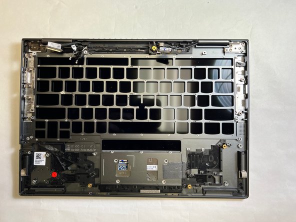

  19. Lenovo ThinkPad X1 Yoga (6th Gen) Keyboard and Touchpad Assembly Replacement: crwdns2935265:019crwdnd2935265:01crwdnd2935265:01crwdne2935265:0
    • Use a Phillips #00 screwdriver to remove the fifty-eight 2.0 mm screws securing the keyboard.
    • Wedge a spudger between the keyboard and the chassis to lift the keyboard out of the shell.

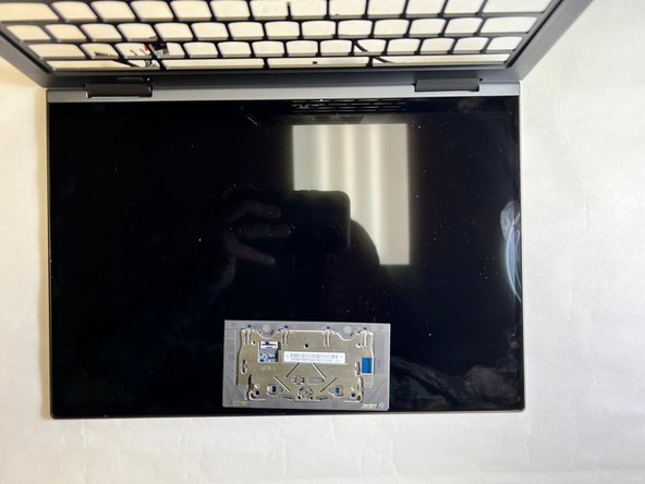

  20. Lenovo ThinkPad X1 Yoga (6th Gen) Keyboard and Touchpad Assembly Replacement: crwdns2935265:020crwdnd2935265:01crwdnd2935265:03crwdne2935265:0 Lenovo ThinkPad X1 Yoga (6th Gen) Keyboard and Touchpad Assembly Replacement: crwdns2935265:020crwdnd2935265:02crwdnd2935265:03crwdne2935265:0 Lenovo ThinkPad X1 Yoga (6th Gen) Keyboard and Touchpad Assembly Replacement: crwdns2935265:020crwdnd2935265:03crwdnd2935265:03crwdne2935265:0
    • Use a Phillips #1 screwdriver to remove the four 2.0 mm screws securing the trackpad.
    • Lift up the body shell for the keyboard to remove the trackpad.
