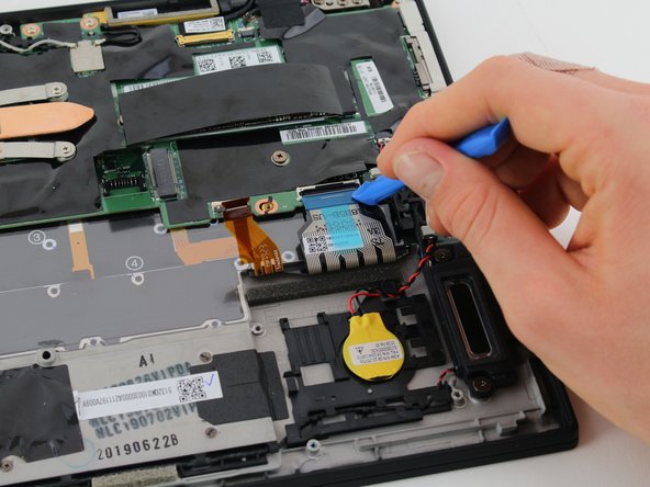

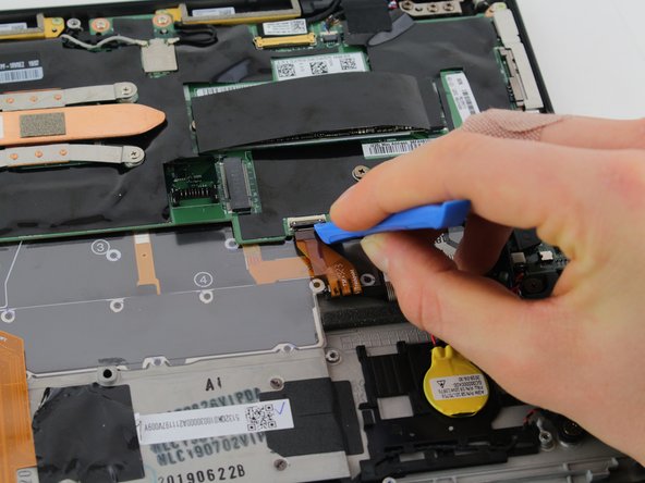

  6. Lenovo ThinkPad X1 Carbon 7th Gen Motherboard Replacement, Motherboard: crwdns2935265:06crwdnd2935265:01crwdnd2935265:02crwdne2935265:0 Lenovo ThinkPad X1 Carbon 7th Gen Motherboard Replacement, Motherboard: crwdns2935265:06crwdnd2935265:02crwdnd2935265:02crwdne2935265:0
    • Remove the connectors with bar latches by lifting up on the small bar behind the port and pulling the circuit ribbon away from the port.
  7. Lenovo ThinkPad X1 Carbon 7th Gen Motherboard Replacement: crwdns2935265:07crwdnd2935265:01crwdnd2935265:03crwdne2935265:0 Lenovo ThinkPad X1 Carbon 7th Gen Motherboard Replacement: crwdns2935265:07crwdnd2935265:02crwdnd2935265:03crwdne2935265:0 Lenovo ThinkPad X1 Carbon 7th Gen Motherboard Replacement: crwdns2935265:07crwdnd2935265:03crwdnd2935265:03crwdne2935265:0
    • Remove the snap connectors by lifting straight up until the connection pops out.
    • Use an opening tool to pry them off if a finger cannot get underneath the connection.
  8. Lenovo ThinkPad X1 Carbon 7th Gen Motherboard Replacement: crwdns2935265:08crwdnd2935265:01crwdnd2935265:03crwdne2935265:0 Lenovo ThinkPad X1 Carbon 7th Gen Motherboard Replacement: crwdns2935265:08crwdnd2935265:02crwdnd2935265:03crwdne2935265:0 Lenovo ThinkPad X1 Carbon 7th Gen Motherboard Replacement: crwdns2935265:08crwdnd2935265:03crwdnd2935265:03crwdne2935265:0
    • Remove the latch connections by lifting the latch up, releasing the circuit ribbon.
    • Use an opening tool to get underneath the latch if a finger cannot.
