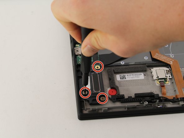

  6. Lenovo ThinkPad X1 Carbon 7th Gen Lower Speakers Replacement, Lower Speakers: crwdns2935265:06crwdnd2935265:01crwdnd2935265:02crwdne2935265:0 Lenovo ThinkPad X1 Carbon 7th Gen Lower Speakers Replacement, Lower Speakers: crwdns2935265:06crwdnd2935265:02crwdnd2935265:02crwdne2935265:0
    • Remove three 8mm Phillips #0 screws from both the left and right side speakers.
    • You are not required to remove the battery in order to remove these speakers.
