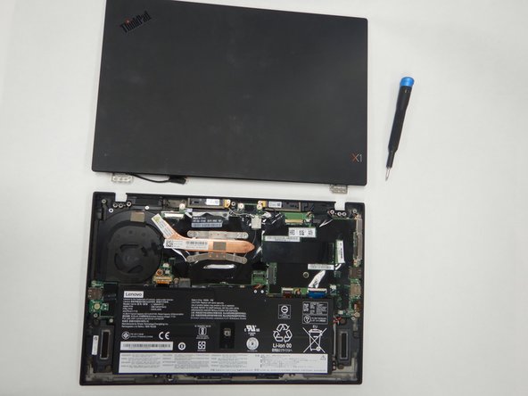

  4. Lenovo ThinkPad X1 Carbon 7th Gen Display Replacement, Display: crwdns2935265:04crwdnd2935265:01crwdnd2935265:01crwdne2935265:0
    • Remove the six 2mm screws from the display hinges using a Phillips #0 screwdriver.
    • Remove each of the cables connecting the display assembly to the motherboard:
    • A display cable on the left
    • Two coaxial cables in the middle
    • Two more cables on the right
  5. Lenovo ThinkPad X1 Carbon 7th Gen Display Replacement: crwdns2935265:05crwdnd2935265:01crwdnd2935265:02crwdne2935265:0 Lenovo ThinkPad X1 Carbon 7th Gen Display Replacement: crwdns2935265:05crwdnd2935265:02crwdnd2935265:02crwdne2935265:0
    • Lift the computer up and rotate the display backwards until it is detached from the rest of the computer as shown.
