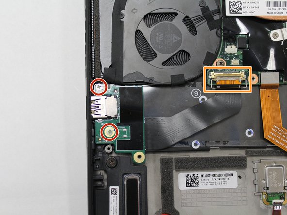

  6. Lenovo ThinkPad X1 Carbon 7th Gen Daughterboard Replacement, Daughterboard: crwdns2935265:06crwdnd2935265:01crwdnd2935265:02crwdne2935265:0 Lenovo ThinkPad X1 Carbon 7th Gen Daughterboard Replacement, Daughterboard: crwdns2935265:06crwdnd2935265:02crwdnd2935265:02crwdne2935265:0
    • Remove the two 1.3 mm screws with a Phillips #0 screwdriver.
    • Disconnect the interconnect cable from the motherboard by flipping up the locking lever and pulling out the ribbon cable.
  7. Lenovo ThinkPad X1 Carbon 7th Gen Daughterboard Replacement: crwdns2935265:07crwdnd2935265:01crwdnd2935265:01crwdne2935265:0
    • Lift the right side of the daughterboard up, then slide the daughterboard to the right to remove it from the computer.
