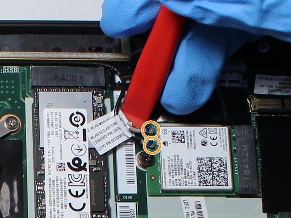

  5. Lenovo ThinkPad X1 Carbon 6th Gen Wi-Fi Card Replacement, Wi-Fi Card: crwdns2935265:05crwdnd2935265:01crwdnd2935265:03crwdne2935265:0 Lenovo ThinkPad X1 Carbon 6th Gen Wi-Fi Card Replacement, Wi-Fi Card: crwdns2935265:05crwdnd2935265:02crwdnd2935265:03crwdne2935265:0 Lenovo ThinkPad X1 Carbon 6th Gen Wi-Fi Card Replacement, Wi-Fi Card: crwdns2935265:05crwdnd2935265:03crwdnd2935265:03crwdne2935265:0
    • Locate the Wi-Fi Card on the side of the device opposite to the fan. It should have one black and one white pin connector wires as well as one retainer screw.
    • Use a plastic opening tool to lift up the two coaxial cables from the Wi-Fi Card.
  6. Lenovo ThinkPad X1 Carbon 6th Gen Wi-Fi Card Replacement: crwdns2935265:06crwdnd2935265:01crwdnd2935265:01crwdne2935265:0
    • Use a Phillips #0 Screwdriver to unscrew the 3 mm screw holding down the Wifi card.

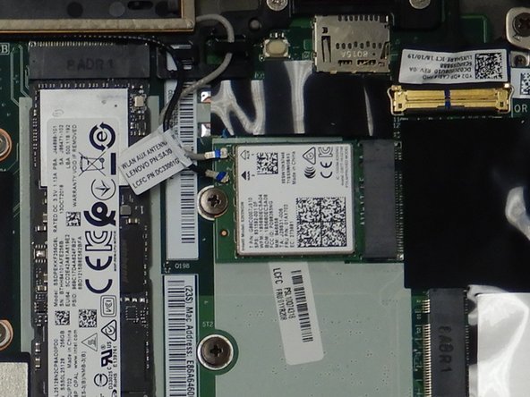

  7. Lenovo ThinkPad X1 Carbon 6th Gen Wi-Fi Card Replacement: crwdns2935265:07crwdnd2935265:01crwdnd2935265:01crwdne2935265:0
    • Carefully slide the Wifi Card towards the center of the device to disconnect it.
    • It may help to use an opening tool to get some leverage and slide it out.
  8. Lenovo ThinkPad X1 Carbon 6th Gen Wi-Fi Card Replacement: crwdns2935265:08crwdnd2935265:01crwdnd2935265:01crwdne2935265:0
    • Your Wifi Card is now removed.
