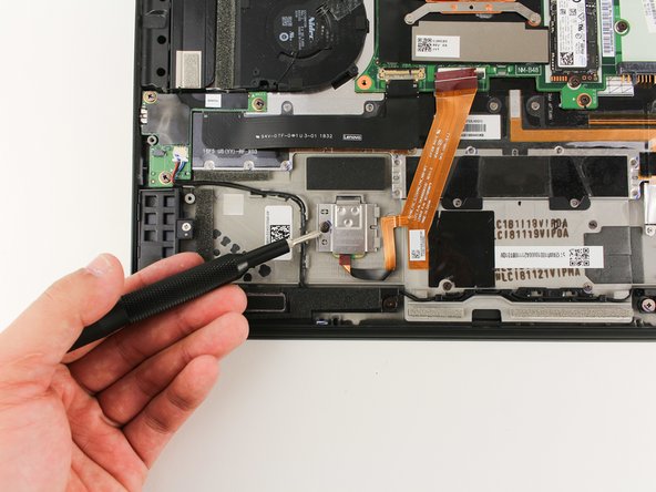

  5. Lenovo ThinkPad X1 Carbon 6th Gen Touchpad Replacement, Fingerprint Scanner: crwdns2935265:05crwdnd2935265:01crwdnd2935265:02crwdne2935265:0 Lenovo ThinkPad X1 Carbon 6th Gen Touchpad Replacement, Fingerprint Scanner: crwdns2935265:05crwdnd2935265:02crwdnd2935265:02crwdne2935265:0
    • Use the Phillips #0 screwdriver to remove the 2mm screw that secures the cover of the fingerprint scanner.
  6. Lenovo ThinkPad X1 Carbon 6th Gen Touchpad Replacement: crwdns2935265:06crwdnd2935265:01crwdnd2935265:01crwdne2935265:0
    • Remove the cover by grabbing it and gently pulling up and to the left.
  7. Lenovo ThinkPad X1 Carbon 6th Gen Touchpad Replacement: crwdns2935265:07crwdnd2935265:01crwdnd2935265:02crwdne2935265:0 Lenovo ThinkPad X1 Carbon 6th Gen Touchpad Replacement: crwdns2935265:07crwdnd2935265:02crwdnd2935265:02crwdne2935265:0
    • Use a nylon spudger to lift up the black bar that secures the cable.
    • Disconnect the ribbon cable from the fingerprint scanner by pulling the cable directly out.

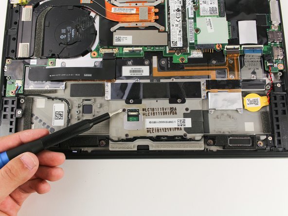

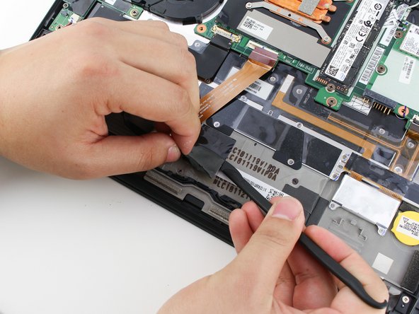

  8. Lenovo ThinkPad X1 Carbon 6th Gen Touchpad Replacement, Touchpad: crwdns2935265:08crwdnd2935265:01crwdnd2935265:02crwdne2935265:0 Lenovo ThinkPad X1 Carbon 6th Gen Touchpad Replacement, Touchpad: crwdns2935265:08crwdnd2935265:02crwdnd2935265:02crwdne2935265:0
    • Use a spudger to peel back the black adhesive pad.
    • Be gentle; the black adhesive pad is delicate and may rip.

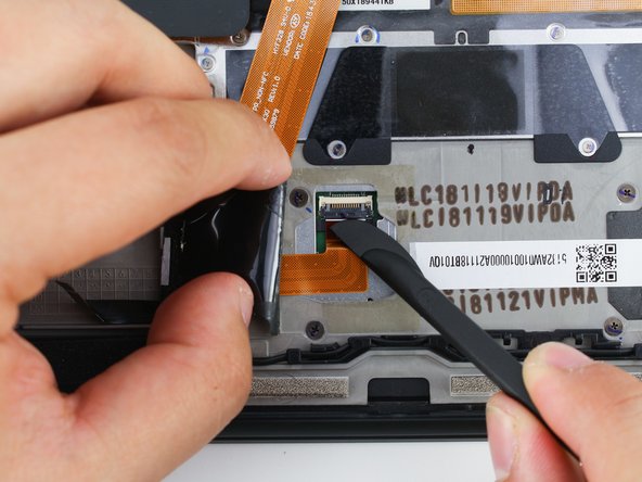

  9. Lenovo ThinkPad X1 Carbon 6th Gen Touchpad Replacement: crwdns2935265:09crwdnd2935265:01crwdnd2935265:02crwdne2935265:0 Lenovo ThinkPad X1 Carbon 6th Gen Touchpad Replacement: crwdns2935265:09crwdnd2935265:02crwdnd2935265:02crwdne2935265:0
    • Lift the lever that secures the cable.
    • Pull the cable out to disconnect the ribbon cable that connects to the touchpad.
    • This is the same procedure for removing most of the ribbon cables.
