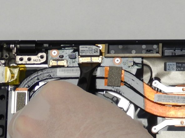

    • Disconnect the two display cables from the motherboard by lifting the press fit connectors off the board with a spudger.

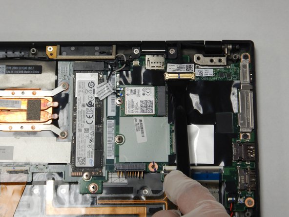

    • Using a Phillips #0 screwdriver, remove the six 5 mm screws connecting the display hinges to the device.

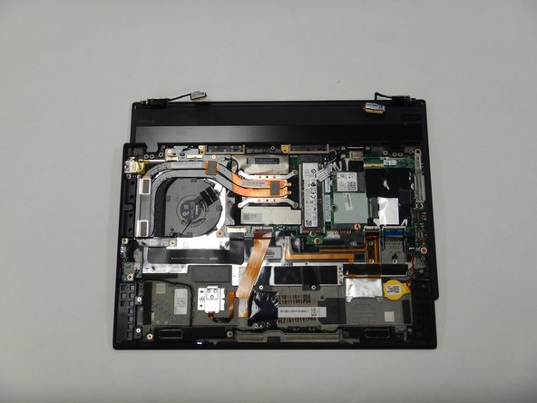

    • Open the device display to open the hinges.
    • Pull the raised half towards yourself to remove the key board.
