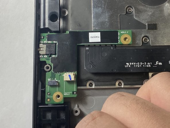

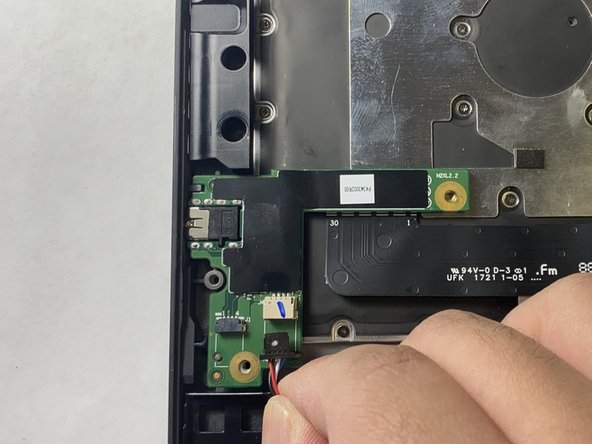

    • Use the Phillips #1 screwdriver to remove the two 1.2 mm screws.
  7. Lenovo ThinkPad X1 Carbon 5th Gen Speakers Replacement  Replacement: crwdns2935265:07crwdnd2935265:01crwdnd2935265:03crwdne2935265:0 Lenovo ThinkPad X1 Carbon 5th Gen Speakers Replacement  Replacement: crwdns2935265:07crwdnd2935265:02crwdnd2935265:03crwdne2935265:0 Lenovo ThinkPad X1 Carbon 5th Gen Speakers Replacement  Replacement: crwdns2935265:07crwdnd2935265:03crwdnd2935265:03crwdne2935265:0
    • Unplug the speaker cable from the board.
  8. Lenovo ThinkPad X1 Carbon 5th Gen Speakers Replacement  Replacement: crwdns2935265:08crwdnd2935265:01crwdnd2935265:03crwdne2935265:0 Lenovo ThinkPad X1 Carbon 5th Gen Speakers Replacement  Replacement: crwdns2935265:08crwdnd2935265:02crwdnd2935265:03crwdne2935265:0 Lenovo ThinkPad X1 Carbon 5th Gen Speakers Replacement  Replacement: crwdns2935265:08crwdnd2935265:03crwdnd2935265:03crwdne2935265:0
    • Lift up the marked latch and remove the cable.
    • Remove the speaker.
