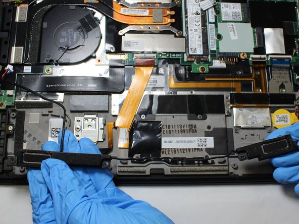

  5. Lenovo ThinkPad X1 Carbon (6th Gen) Speakers Replacement, Speakers: crwdns2935265:05crwdnd2935265:01crwdnd2935265:03crwdne2935265:0 Lenovo ThinkPad X1 Carbon (6th Gen) Speakers Replacement, Speakers: crwdns2935265:05crwdnd2935265:02crwdnd2935265:03crwdne2935265:0 Lenovo ThinkPad X1 Carbon (6th Gen) Speakers Replacement, Speakers: crwdns2935265:05crwdnd2935265:03crwdnd2935265:03crwdne2935265:0
    • Gently grab the widest edges of the speaker cable and pull the cable out towards the speakers.
    • Use a Phillips #0 screwdriver to remove the four 5 mm screws.
  6. Lenovo ThinkPad X1 Carbon (6th Gen) Speakers Replacement: crwdns2935265:06crwdnd2935265:01crwdnd2935265:02crwdne2935265:0 Lenovo ThinkPad X1 Carbon (6th Gen) Speakers Replacement: crwdns2935265:06crwdnd2935265:02crwdnd2935265:02crwdne2935265:0
    • The cable between the two speakers is interwoven between a plastic retainer. It can be easier to remove in a zig-zag motion.
    • Lift the speakers starting with the cable you disconnected earlier. Continue to unravel the cable between the two speakers until the unit lifts freely.
