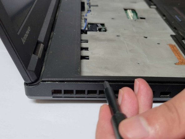

    • Slot the pry bar below the keypad as shown in the first picture below and push upwards.
    • Remove the six Phillips #000 screws circled with red in the second picture, lift up the keyboard.

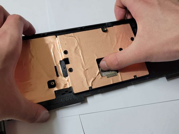

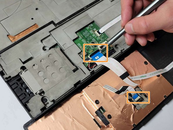

  3. Lenovo ThinkPad W541 Touchpad Replacement: crwdns2935265:03crwdnd2935265:01crwdnd2935265:03crwdne2935265:0 Lenovo ThinkPad W541 Touchpad Replacement: crwdns2935265:03crwdnd2935265:02crwdnd2935265:03crwdne2935265:0 Lenovo ThinkPad W541 Touchpad Replacement: crwdns2935265:03crwdnd2935265:03crwdnd2935265:03crwdne2935265:0
    • Open the black clips connected to the motherboard and remove the ribbon cable.
    • Use a pry bar to pry open the black protective casing upwards.
    • Flip the casing over. Open the black clips upwards and remove the cable.

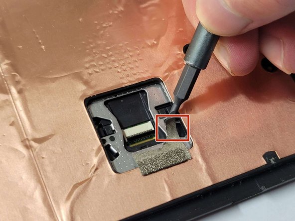

  4. Lenovo ThinkPad W541 Touchpad Replacement: crwdns2935265:04crwdnd2935265:01crwdnd2935265:03crwdne2935265:0 Lenovo ThinkPad W541 Touchpad Replacement: crwdns2935265:04crwdnd2935265:02crwdnd2935265:03crwdne2935265:0 Lenovo ThinkPad W541 Touchpad Replacement: crwdns2935265:04crwdnd2935265:03crwdnd2935265:03crwdne2935265:0
    • Remove the four 2.0 mm Phillips #000 screws circled with red in the first picture.
    • Carefully remove the metal tape and save for reassembly.
    • Apply slight pressure to the back of the broken trackpad.
