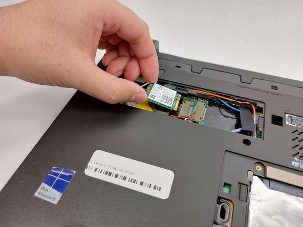

    • Use a Phillips #0 screwdriver to unscrew the captive screw that secures the Wi-Fi card compartment plate.
    • The screw that holds on to the WiFi card compartment plate should hold on to the plate itself. So you shouldn't worry about losing it
    • Note the position of the gray and black cables on the Wi-Fi card.
  2. Lenovo ThinkPad W540 Wi-Fi Card Replacement: crwdns2935265:02crwdnd2935265:01crwdnd2935265:03crwdne2935265:0 Lenovo ThinkPad W540 Wi-Fi Card Replacement: crwdns2935265:02crwdnd2935265:02crwdnd2935265:03crwdne2935265:0 Lenovo ThinkPad W540 Wi-Fi Card Replacement: crwdns2935265:02crwdnd2935265:03crwdnd2935265:03crwdne2935265:0
    • Using your Tweezers start with either of the gray or black cables and carefully dislodge them
  3. Lenovo ThinkPad W540 Wi-Fi Card Replacement: crwdns2935265:03crwdnd2935265:01crwdnd2935265:02crwdne2935265:0 Lenovo ThinkPad W540 Wi-Fi Card Replacement: crwdns2935265:03crwdnd2935265:02crwdnd2935265:02crwdne2935265:0
    • Use a Phillips #00 screwdriver to remove the 3 mm screw that fastens the Wi-Fi card.
  4. Lenovo ThinkPad W540 Wi-Fi Card Replacement: crwdns2935265:04crwdnd2935265:01crwdnd2935265:02crwdne2935265:0 Lenovo ThinkPad W540 Wi-Fi Card Replacement: crwdns2935265:04crwdnd2935265:02crwdnd2935265:02crwdne2935265:0
    • Using your hand or a capable device, carefully detach the Wi-Fi card.
