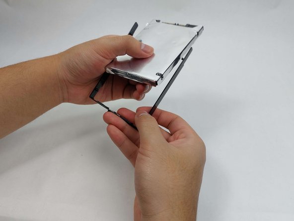

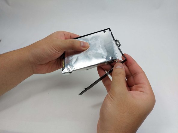

  4. Lenovo ThinkPad W540 Hard Drive Replacement: crwdns2935265:04crwdnd2935265:01crwdnd2935265:03crwdne2935265:0 Lenovo ThinkPad W540 Hard Drive Replacement: crwdns2935265:04crwdnd2935265:02crwdnd2935265:03crwdne2935265:0 Lenovo ThinkPad W540 Hard Drive Replacement: crwdns2935265:04crwdnd2935265:03crwdnd2935265:03crwdne2935265:0
    • Safely remove the plastic guard surrounding both the hard drive and ESD shielding.
  5. Lenovo ThinkPad W540 Hard Drive Replacement: crwdns2935265:05crwdnd2935265:01crwdnd2935265:02crwdne2935265:0 Lenovo ThinkPad W540 Hard Drive Replacement: crwdns2935265:05crwdnd2935265:02crwdnd2935265:02crwdne2935265:0
    • Carefully removing the ESD shielding surrounding the hard drive.
    • Do not disregard the ESD shielding unless your new hard drive or SSD comes with its own shielding. Failure to do so will lead to severe damage to your device.
