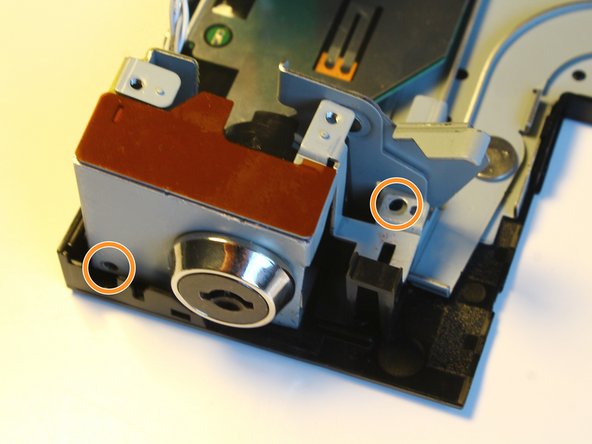

    • Remove all marked screws and keep them save
    • The colors of the screws might be exchanged
    • For best results please remind yourself which screws you removed from where

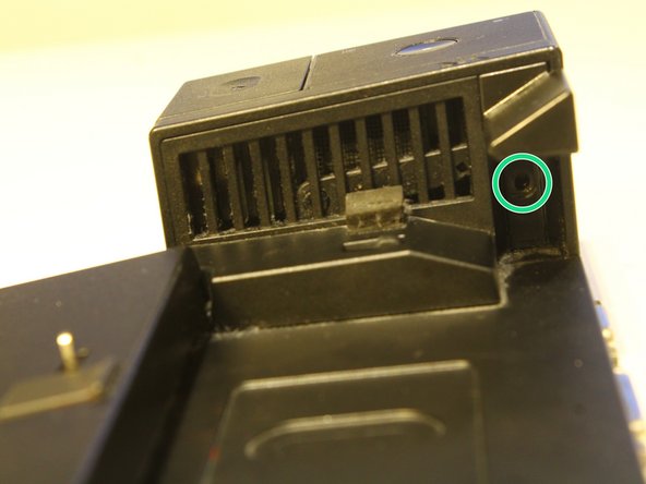

  2. Lenovo ThinkPad Ultra Dock broken lock replacement: crwdns2935265:02crwdnd2935265:01crwdnd2935265:03crwdne2935265:0 Lenovo ThinkPad Ultra Dock broken lock replacement: crwdns2935265:02crwdnd2935265:02crwdnd2935265:03crwdne2935265:0 Lenovo ThinkPad Ultra Dock broken lock replacement: crwdns2935265:02crwdnd2935265:03crwdnd2935265:03crwdne2935265:0
    • Remove also those screws

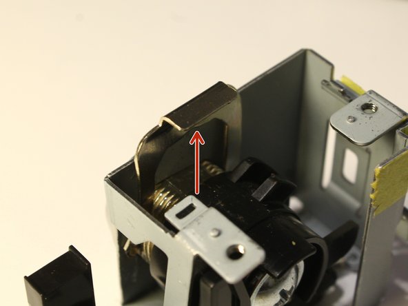

  6. Lenovo ThinkPad Ultra Dock broken lock replacement: crwdns2935265:06crwdnd2935265:01crwdnd2935265:02crwdne2935265:0 Lenovo ThinkPad Ultra Dock broken lock replacement: crwdns2935265:06crwdnd2935265:02crwdnd2935265:02crwdne2935265:0
    • I suggest you to glue the spring on the second picture on the bottom. It will be easier for to reassemble the device later

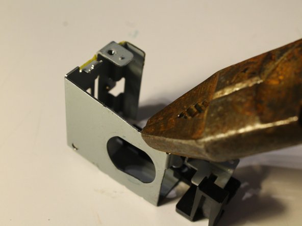

  10. Lenovo ThinkPad Ultra Dock broken lock replacement: crwdns2935265:010crwdnd2935265:01crwdnd2935265:02crwdne2935265:0 Lenovo ThinkPad Ultra Dock broken lock replacement: crwdns2935265:010crwdnd2935265:02crwdnd2935265:02crwdne2935265:0
    • remove the lock
    • Try to bend all the metall structures back into their right shape
    • But pay attention that the metall doesn't break!

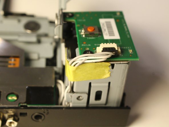

  11. Lenovo ThinkPad Ultra Dock broken lock replacement: crwdns2935265:011crwdnd2935265:01crwdnd2935265:02crwdne2935265:0 Lenovo ThinkPad Ultra Dock broken lock replacement: crwdns2935265:011crwdnd2935265:02crwdnd2935265:02crwdne2935265:0
    • This spring snaps out very easy so pay attention that it is still inplace before you assemble every thing again
    • Watch out for the tape! Make sure that it is covering the cables and make also sure that the cables are on the right place
