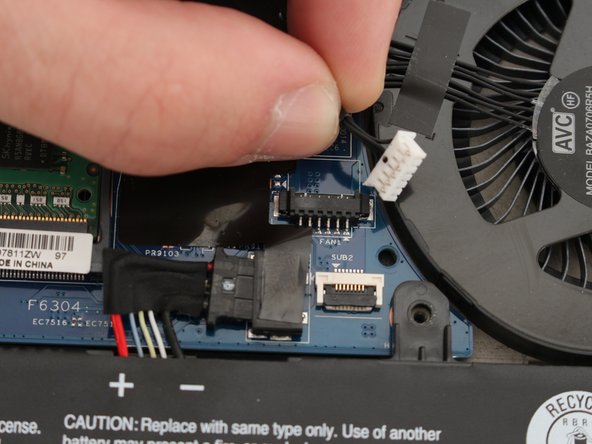

  9. Lenovo ThinkPad T580 Motherboard Replacement, Cooling Fan: crwdns2935265:09crwdnd2935265:01crwdnd2935265:02crwdne2935265:0 Lenovo ThinkPad T580 Motherboard Replacement, Cooling Fan: crwdns2935265:09crwdnd2935265:02crwdnd2935265:02crwdne2935265:0
    • Unplug the cooling fan's cable from the the motherboard.

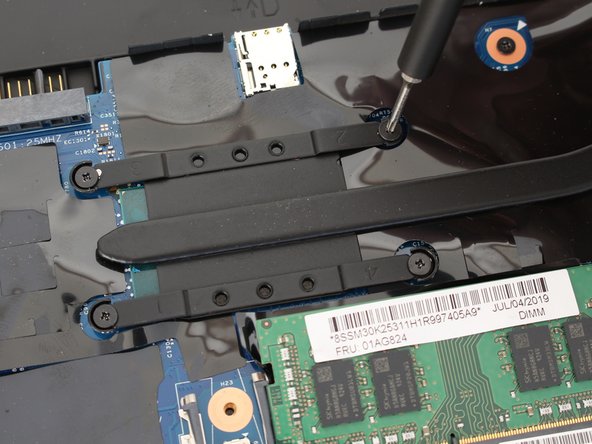

  10. Lenovo ThinkPad T580 Motherboard Replacement: crwdns2935265:010crwdnd2935265:01crwdnd2935265:03crwdne2935265:0 Lenovo ThinkPad T580 Motherboard Replacement: crwdns2935265:010crwdnd2935265:02crwdnd2935265:03crwdne2935265:0 Lenovo ThinkPad T580 Motherboard Replacement: crwdns2935265:010crwdnd2935265:03crwdnd2935265:03crwdne2935265:0
    • Using a Phillips #00 screwdriver, unscrew five 4.6 mm screws fastening the fan and cooling pipe.
    • The screws are set in the plastic and are not able to be removed from the fan parts.
  11. Lenovo ThinkPad T580 Motherboard Replacement: crwdns2935265:011crwdnd2935265:01crwdnd2935265:01crwdne2935265:0
    • Remove the cooling fan directly upwards from the core.
    • Be sure to clean and replace any thermal paste on the heatsink and CPU before reassembling. You can use our How to Apply Thermal Paste guide if you need any help!

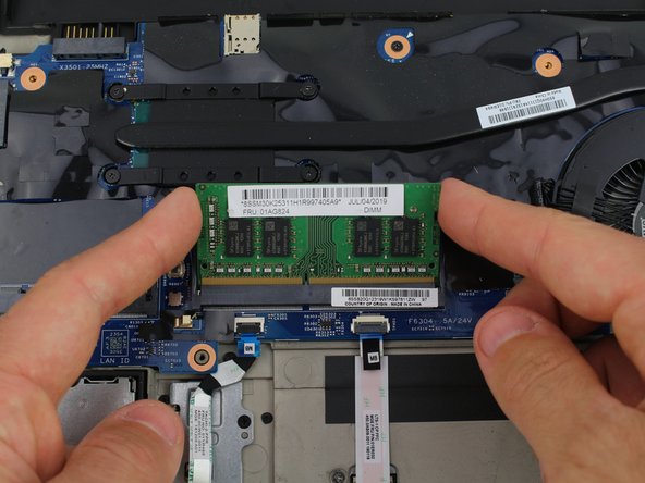

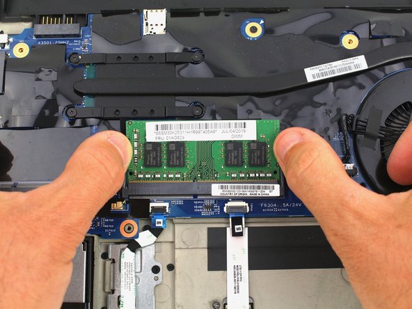

  15. Lenovo ThinkPad T580 Motherboard Replacement, RAM: crwdns2935265:015crwdnd2935265:01crwdnd2935265:03crwdne2935265:0 Lenovo ThinkPad T580 Motherboard Replacement, RAM: crwdns2935265:015crwdnd2935265:02crwdnd2935265:03crwdne2935265:0 Lenovo ThinkPad T580 Motherboard Replacement, RAM: crwdns2935265:015crwdnd2935265:03crwdnd2935265:03crwdne2935265:0
    • Pull the two tabs on either side of the RAM card outwards with your fingers.
  16. Lenovo ThinkPad T580 Motherboard Replacement: crwdns2935265:016crwdnd2935265:01crwdnd2935265:03crwdne2935265:0 Lenovo ThinkPad T580 Motherboard Replacement: crwdns2935265:016crwdnd2935265:02crwdnd2935265:03crwdne2935265:0 Lenovo ThinkPad T580 Motherboard Replacement: crwdns2935265:016crwdnd2935265:03crwdnd2935265:03crwdne2935265:0
    • The RAM module should pop up to rest at an angle to the motherboard.
    • Pull the Wi-Fi card out from the port by the edges of the card.
    • Try to remove and insert the card at the same angle at which it rests with respect to the motherboard.
  17. Lenovo ThinkPad T580 Motherboard Replacement: crwdns2935265:017crwdnd2935265:01crwdnd2935265:02crwdne2935265:0 Lenovo ThinkPad T580 Motherboard Replacement: crwdns2935265:017crwdnd2935265:02crwdnd2935265:02crwdne2935265:0
    • Remove the RAM module from the laptop.
    • Repeat the same process for the second RAM module if your computer included one.

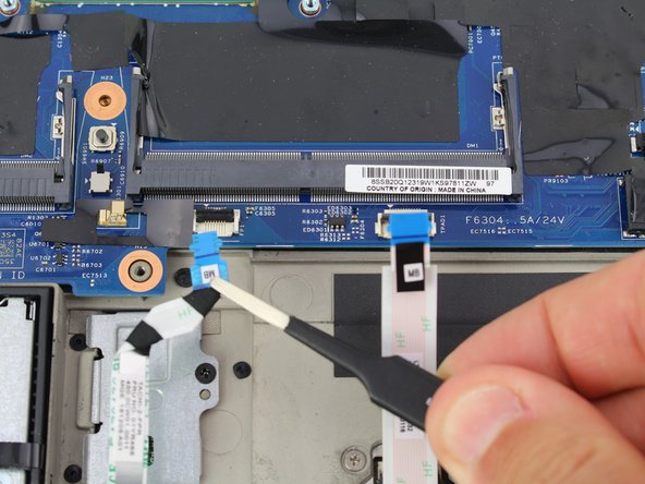

  22. Lenovo ThinkPad T580 Motherboard Replacement: crwdns2935265:022crwdnd2935265:01crwdnd2935265:03crwdne2935265:0 Lenovo ThinkPad T580 Motherboard Replacement: crwdns2935265:022crwdnd2935265:02crwdnd2935265:03crwdne2935265:0 Lenovo ThinkPad T580 Motherboard Replacement: crwdns2935265:022crwdnd2935265:03crwdnd2935265:03crwdne2935265:0

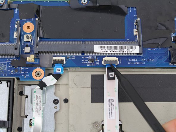

    • Use a spudger to lift up the two black, hinged locking flaps on the ZIF connectors on the motherboard.
  23. Lenovo ThinkPad T580 Motherboard Replacement: crwdns2935265:023crwdnd2935265:01crwdnd2935265:03crwdne2935265:0 Lenovo ThinkPad T580 Motherboard Replacement: crwdns2935265:023crwdnd2935265:02crwdnd2935265:03crwdne2935265:0 Lenovo ThinkPad T580 Motherboard Replacement: crwdns2935265:023crwdnd2935265:03crwdnd2935265:03crwdne2935265:0
    • Use a pair of blunt nose tweezers to pull the two keyboard ribbon cables out from the ZIF connectors.

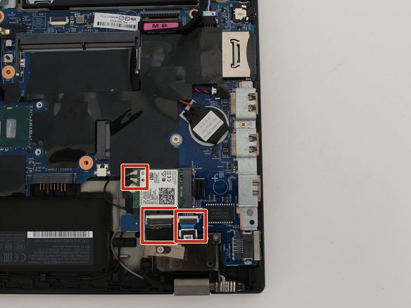

    • Disconnect all the attached cables.

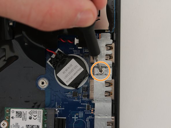

  26. Lenovo ThinkPad T580 Motherboard Replacement: crwdns2935265:026crwdnd2935265:01crwdnd2935265:03crwdne2935265:0 Lenovo ThinkPad T580 Motherboard Replacement: crwdns2935265:026crwdnd2935265:02crwdnd2935265:03crwdne2935265:0 Lenovo ThinkPad T580 Motherboard Replacement: crwdns2935265:026crwdnd2935265:03crwdnd2935265:03crwdne2935265:0
    • Using a Phillips #00 screwdriver, unscrew the three 3.3 mm motherboard screws.
    • Using a Phillips #00 screwdriver, take out the port clamps and the three 3.6 mm screws.

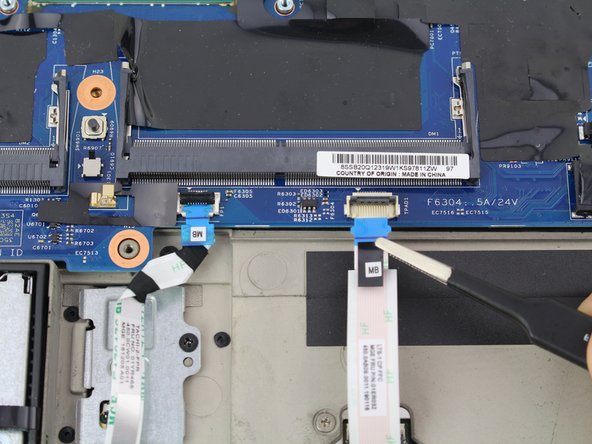

  27. Lenovo ThinkPad T580 Motherboard Replacement: crwdns2935265:027crwdnd2935265:01crwdnd2935265:03crwdne2935265:0 Lenovo ThinkPad T580 Motherboard Replacement: crwdns2935265:027crwdnd2935265:02crwdnd2935265:03crwdne2935265:0 Lenovo ThinkPad T580 Motherboard Replacement: crwdns2935265:027crwdnd2935265:03crwdnd2935265:03crwdne2935265:0

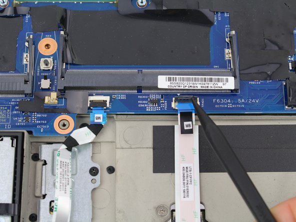

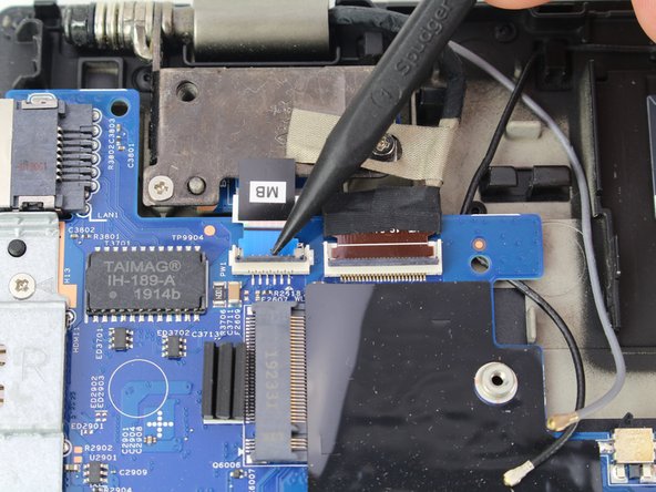

    • Flip up the two ZIF cables for the trackpad and fingerprint sensor with the pointed end of a plastic spudger.
  28. Lenovo ThinkPad T580 Motherboard Replacement: crwdns2935265:028crwdnd2935265:01crwdnd2935265:03crwdne2935265:0 Lenovo ThinkPad T580 Motherboard Replacement: crwdns2935265:028crwdnd2935265:02crwdnd2935265:03crwdne2935265:0 Lenovo ThinkPad T580 Motherboard Replacement: crwdns2935265:028crwdnd2935265:03crwdnd2935265:03crwdne2935265:0
    • Pull out the two ribbon cables with a pair of blunt nose tweezers.

    • Using a spudger, flip up the locking tabs of the two ZIF connectors on the upper left corner of the motherboard.
    • Pull out each of the ribbon cables using a pair of blunt nose tweezers.

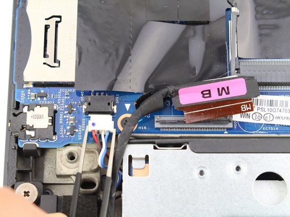

  30. Lenovo ThinkPad T580 Motherboard Replacement: crwdns2935265:030crwdnd2935265:01crwdnd2935265:03crwdne2935265:0 Lenovo ThinkPad T580 Motherboard Replacement: crwdns2935265:030crwdnd2935265:02crwdnd2935265:03crwdne2935265:0 Lenovo ThinkPad T580 Motherboard Replacement: crwdns2935265:030crwdnd2935265:03crwdnd2935265:03crwdne2935265:0

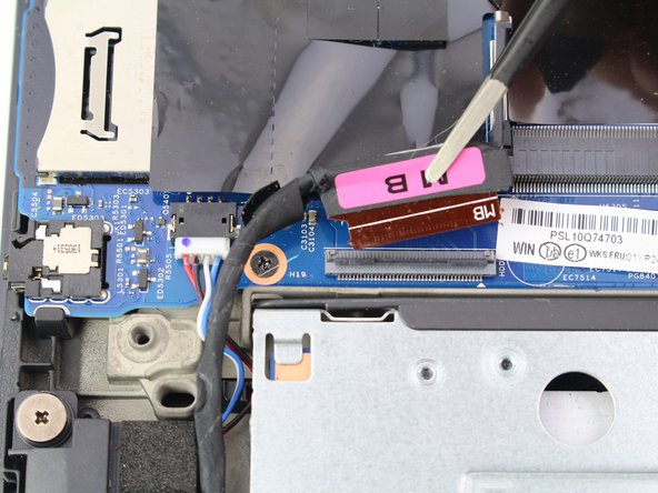

    • Flip up the locking tab of the ZIF connector on the bottom left of the motherboard.
    • Pull out the ribbon cable and speaker cable from their connectors using a pair of blunt nose tweezers.

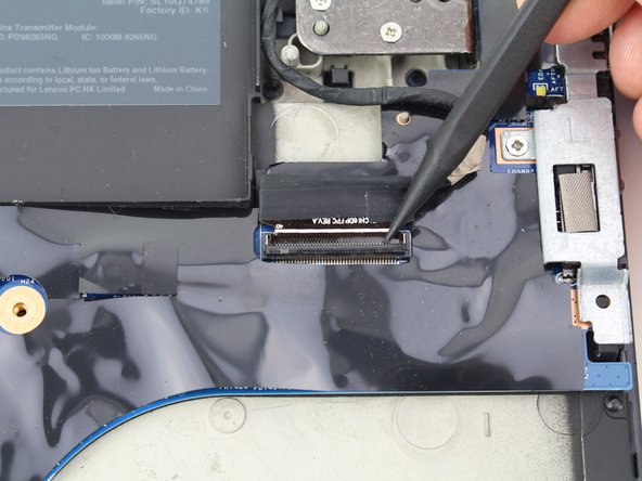

  31. Lenovo ThinkPad T580 Motherboard Replacement: crwdns2935265:031crwdnd2935265:01crwdnd2935265:03crwdne2935265:0 Lenovo ThinkPad T580 Motherboard Replacement: crwdns2935265:031crwdnd2935265:02crwdnd2935265:03crwdne2935265:0 Lenovo ThinkPad T580 Motherboard Replacement: crwdns2935265:031crwdnd2935265:03crwdnd2935265:03crwdne2935265:0

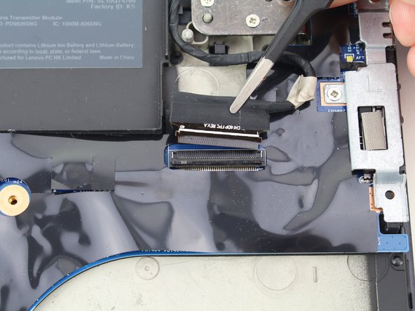

    • Using a spudger, flip up the locking tab of the ZIF connector in the top right corner of the motherboard.
    • Pull the ribbon cable out from the connector with a pair of blunt nose tweezers.

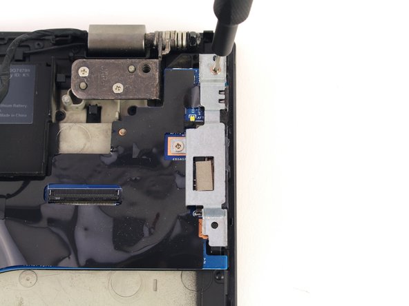

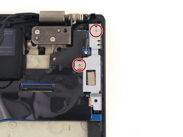

  32. Lenovo ThinkPad T580 Motherboard Replacement: crwdns2935265:032crwdnd2935265:01crwdnd2935265:03crwdne2935265:0 Lenovo ThinkPad T580 Motherboard Replacement: crwdns2935265:032crwdnd2935265:02crwdnd2935265:03crwdne2935265:0 Lenovo ThinkPad T580 Motherboard Replacement: crwdns2935265:032crwdnd2935265:03crwdnd2935265:03crwdne2935265:0

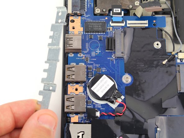

    • Using a Phillips #00 screwdriver, remove the four 3.6 mm screws holding down the port brackets on the right and left sides of the motherboard.
  33. Lenovo ThinkPad T580 Motherboard Replacement: crwdns2935265:033crwdnd2935265:01crwdnd2935265:03crwdne2935265:0 Lenovo ThinkPad T580 Motherboard Replacement: crwdns2935265:033crwdnd2935265:02crwdnd2935265:03crwdne2935265:0 Lenovo ThinkPad T580 Motherboard Replacement: crwdns2935265:033crwdnd2935265:03crwdnd2935265:03crwdne2935265:0
    • Pull off each of the port brackets.

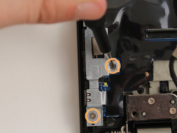

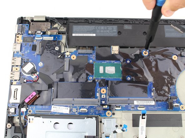

  34. Lenovo ThinkPad T580 Motherboard Replacement: crwdns2935265:034crwdnd2935265:01crwdnd2935265:02crwdne2935265:0 Lenovo ThinkPad T580 Motherboard Replacement: crwdns2935265:034crwdnd2935265:02crwdnd2935265:02crwdne2935265:0
    • Remove the two 3.3 mm screws from the motherboard with a Phillips #00 screwdriver.

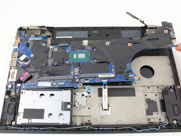

  35. Lenovo ThinkPad T580 Motherboard Replacement: crwdns2935265:035crwdnd2935265:01crwdnd2935265:03crwdne2935265:0 Lenovo ThinkPad T580 Motherboard Replacement: crwdns2935265:035crwdnd2935265:02crwdnd2935265:03crwdne2935265:0 Lenovo ThinkPad T580 Motherboard Replacement: crwdns2935265:035crwdnd2935265:03crwdnd2935265:03crwdne2935265:0
    • Lift up and remove the motherboard.
    • If your replacement motherboard does not include a CMOS battery, you may need to move it over from your old motherboard. You can follow this CMOS Battery Replacement guide if you need help!
