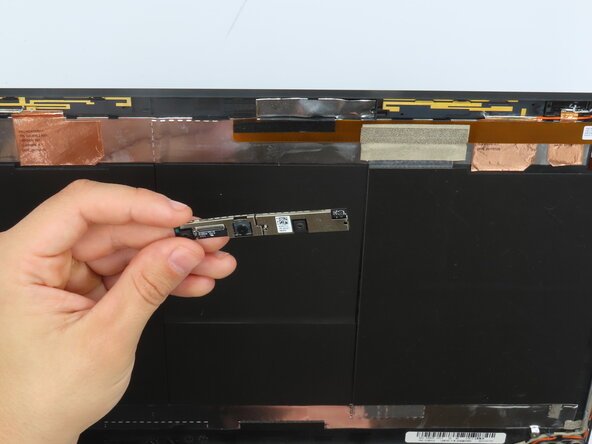

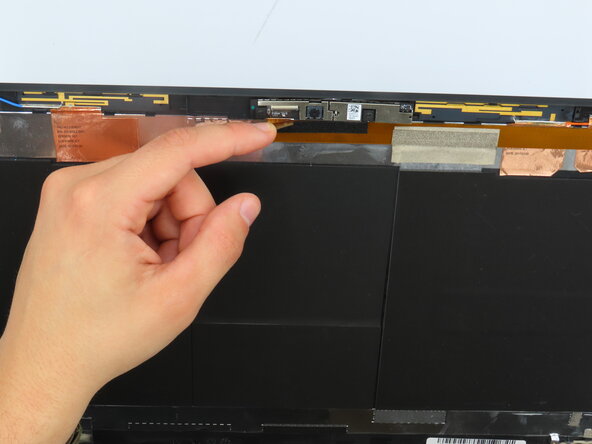

  3. Lenovo ThinkPad T570 Webcam Replacement: crwdns2935265:03crwdnd2935265:01crwdnd2935265:03crwdne2935265:0 Lenovo ThinkPad T570 Webcam Replacement: crwdns2935265:03crwdnd2935265:02crwdnd2935265:03crwdne2935265:0 Lenovo ThinkPad T570 Webcam Replacement: crwdns2935265:03crwdnd2935265:03crwdnd2935265:03crwdne2935265:0
    • Use the plastic opening tool to lift the webcam from the top edge of the screen.
    • The webcam may be slightly adhered; pry gently to avoid damage.
    • Once free, pull the cable to disconnect from the back of the webcam.
    • Lift the webcam out of the space.
