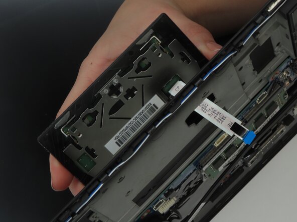

  4. Lenovo ThinkPad T570 Touchpad Replacement, Touchpad: crwdns2935265:04crwdnd2935265:01crwdnd2935265:01crwdne2935265:0
    • Remove the two 3 mm screws that are holding the touchpad in place using a Phillips #0 screwdriver.
  5. Lenovo ThinkPad T570 Touchpad Replacement: crwdns2935265:05crwdnd2935265:01crwdnd2935265:01crwdne2935265:0
    • Unplug the ribbon that is connecting the touchpad to the computer.
  6. Lenovo ThinkPad T570 Touchpad Replacement: crwdns2935265:06crwdnd2935265:01crwdnd2935265:02crwdne2935265:0 Lenovo ThinkPad T570 Touchpad Replacement: crwdns2935265:06crwdnd2935265:02crwdnd2935265:02crwdne2935265:0
    • Remove the touchpad by pulling it away from the computer.
