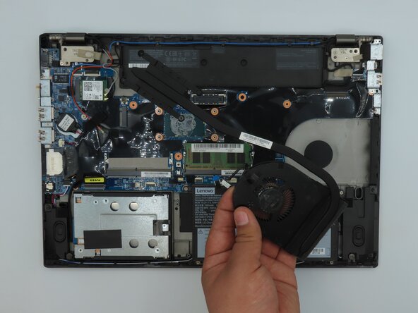

  2. Lenovo ThinkPad T570 Fan & Heatsink Assembly Replacement, Fan & Heatsink Assembly: crwdns2935265:02crwdnd2935265:01crwdnd2935265:01crwdne2935265:0
    • Loosen the five 5 mm screws using a JIS #1 screwdriver.
  3. Lenovo ThinkPad T570 Fan & Heatsink Assembly Replacement: crwdns2935265:03crwdnd2935265:01crwdnd2935265:01crwdne2935265:0
    • Using an iFixit opening tool, pry off the back plate.
  4. Lenovo ThinkPad T570 Fan & Heatsink Assembly Replacement: crwdns2935265:04crwdnd2935265:01crwdnd2935265:01crwdne2935265:0
    • Loosen the four 5 mm screws using a JIS #1 screwdriver.
  5. Lenovo ThinkPad T570 Fan & Heatsink Assembly Replacement: crwdns2935265:05crwdnd2935265:01crwdnd2935265:02crwdne2935265:0 Lenovo ThinkPad T570 Fan & Heatsink Assembly Replacement: crwdns2935265:05crwdnd2935265:02crwdnd2935265:02crwdne2935265:0
    • Detach the fan wire from the motherboard.
    • Remove the fan and heatsink assembly.
