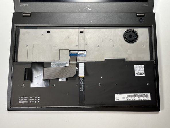

    3. Lenovo ThinkPad T560 Keyboard Replacement: crwdns2935265:03crwdnd2935265:01crwdnd2935265:02crwdne2935265:0 Lenovo ThinkPad T560 Keyboard Replacement: crwdns2935265:03crwdnd2935265:02crwdnd2935265:02crwdne2935265:0
      • Using the spudger, push the keyboard toward the display and then slide it back out of the connector at top of the keyboard to remove.
      • Don't pull on the keyboard as it is attached by two ZIF connectors underneath.
      • Flip the keyboard over to expose the keyboard's connections to the motherboard and touchpad.

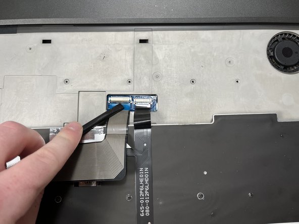

    4. Lenovo ThinkPad T560 Keyboard Replacement: crwdns2935265:04crwdnd2935265:01crwdnd2935265:02crwdne2935265:0 Lenovo ThinkPad T560 Keyboard Replacement: crwdns2935265:04crwdnd2935265:02crwdnd2935265:02crwdne2935265:0
      • Using the spudger, open the latches securing the keyboard's connections to the motherboard and touchpad.
      • Remove the keyboard.
