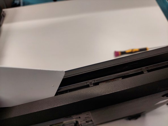

    • Unscrew all screws holding the back panel in place and disconnect the battery.
    • Use a prying tool to release all the clips and remove the panel.

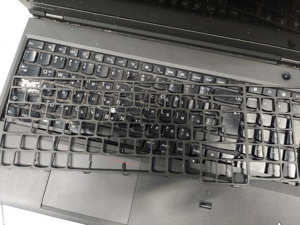

    • Remove the plastic trim around the keyboard keys.

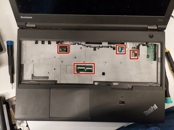

    • Remove the several little screws that hold the keyboard and disconnect it.
    • Disconnect every single connector that you see.

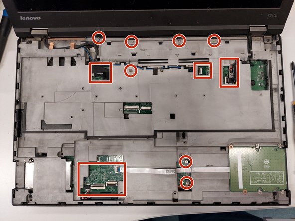

    • Unscrew the bottom plate and once again make sure you disconnected everything.
  3. Lenovo ThinkPad T540p Thermal Paste Replacement, Opening the laptop: crwdns2935265:03crwdnd2935265:01crwdnd2935265:01crwdne2935265:0
    • Remove the pads and unscrew the display.

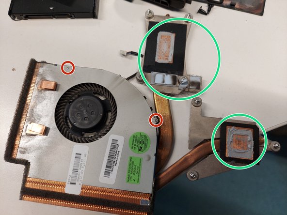

    • Unscrew the 7 screws holding the CPU heatsink and disconnect the fan.
    • Clean the old thermal paste both from the cooler and the CPU. It is best to use isopropyl alcohol and cotton swabs or paper towel, but be careful not to go too hard on the CPU. Also change the thermal pads.

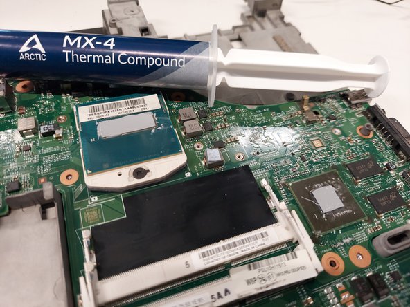

    • Dont use too much thermal paste, just enough to cover some portion of the pad. If you have a spreader, use it. The thermal paste will apply evenly after you tighten the heatsink.
    • Last, put the heatsink back carefully and tighten the screws in order 1 -> 7 to ensure even pressure. Dont forget to plug in the fan cable.
