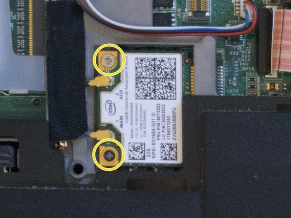

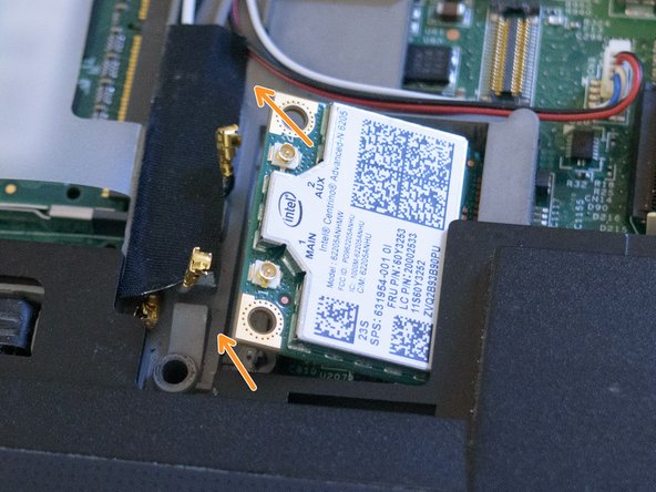

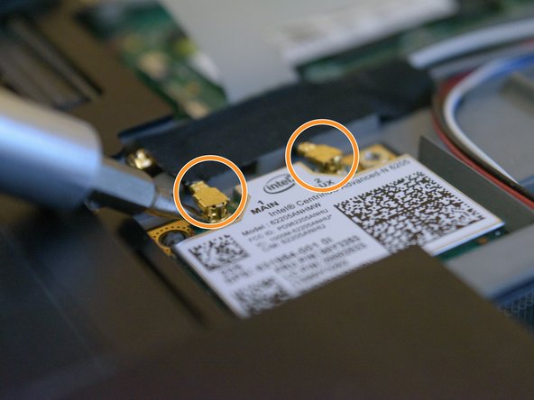

  15. Lenovo ThinkPad T530 WAN Card Replacement, Disconnecting the WAN Card: crwdns2935265:015crwdnd2935265:01crwdnd2935265:03crwdne2935265:0 Lenovo ThinkPad T530 WAN Card Replacement, Disconnecting the WAN Card: crwdns2935265:015crwdnd2935265:02crwdnd2935265:03crwdne2935265:0 Lenovo ThinkPad T530 WAN Card Replacement, Disconnecting the WAN Card: crwdns2935265:015crwdnd2935265:03crwdnd2935265:03crwdne2935265:0
    • Locate the WAN Card highlighted in red.
    • Lift up the two antenna's from the WAN Card gentilly, you can use a flathead screwdriver to assist you.
    • Using a Phillips #00 screwdriver, remove the two screws from the WAN Card.

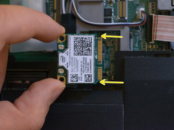

  16. Lenovo ThinkPad T530 WAN Card Replacement, Removing the WAN Card: crwdns2935265:016crwdnd2935265:01crwdnd2935265:03crwdne2935265:0 Lenovo ThinkPad T530 WAN Card Replacement, Removing the WAN Card: crwdns2935265:016crwdnd2935265:02crwdnd2935265:03crwdne2935265:0 Lenovo ThinkPad T530 WAN Card Replacement, Removing the WAN Card: crwdns2935265:016crwdnd2935265:03crwdnd2935265:03crwdne2935265:0
    • Grab the WAN Card from it's corners.
    • Lift up the WAN Card at a 30° angle.
    • Pull the WAN Card out from the slot.
