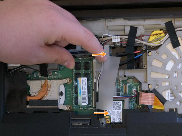

  15. Lenovo ThinkPad T530 Memory Module: Upper Slot Replacement, Removing the Memory Module: crwdns2935265:015crwdnd2935265:01crwdnd2935265:02crwdne2935265:0 Lenovo ThinkPad T530 Memory Module: Upper Slot Replacement, Removing the Memory Module: crwdns2935265:015crwdnd2935265:02crwdnd2935265:02crwdne2935265:0
    • Some models of the Lenovo T530 may not have a top memory module included out of the box, but this guide will help you either install- or replace it .
    • While a Memory Module is visible in the second image, there does not need to be one in the slot inorder to do this step.
    • Locate the SODIMM slot in the middle of the motherboard, there should be a tab of translucent paper near the middle of the keyboard, highlighted in red.
    • Using your finger, move the translucent paper tab away from the memory module, be careful and do not pull it off.

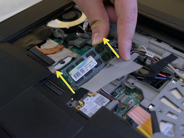

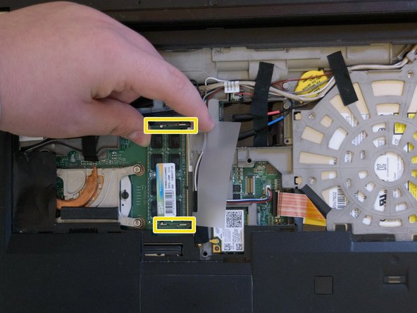

  16. Lenovo ThinkPad T530 Memory Module: Upper Slot Replacement, Removing the Memory Module (Cont.): crwdns2935265:016crwdnd2935265:01crwdnd2935265:02crwdne2935265:0 Lenovo ThinkPad T530 Memory Module: Upper Slot Replacement, Removing the Memory Module (Cont.): crwdns2935265:016crwdnd2935265:02crwdnd2935265:02crwdne2935265:0
    • None of the following instructions should require an exuberant amount of force, using an excessive amount of force may result in damaging your device.
    • The memory module is visible, but we first need to unlock the module from it's clips.
    • On the top and bottom end of the memory module, there are two latches. Put your fingers on the inside of the two latches, then push the latches away (towards the battery, and the trackpad, respectively).
    • Lift the module to a 45° angle, and then pull it out of the slot.
    • Be cautious, the memory module may eject from the slot.
  17. Lenovo ThinkPad T530 Memory Module: Upper Slot Replacement, Installing the Memory Module: crwdns2935265:017crwdnd2935265:01crwdnd2935265:02crwdne2935265:0 Lenovo ThinkPad T530 Memory Module: Upper Slot Replacement, Installing the Memory Module: crwdns2935265:017crwdnd2935265:02crwdnd2935265:02crwdne2935265:0
    • Insert the memory module at a 45° angle with the shorter notched end into the shorter connector.
    • Push the back of the memory module down until the two metal retention arms (highlighted in yellow) lock into place.
