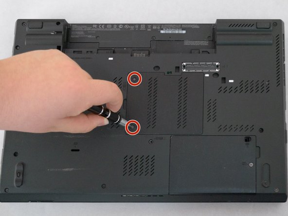

  4. Lenovo ThinkPad T530 Memory Module: Bottom Slot Replacement, Unscrew Rear Memory Cover: crwdns2935265:04crwdnd2935265:01crwdnd2935265:02crwdne2935265:0 Lenovo ThinkPad T530 Memory Module: Bottom Slot Replacement, Unscrew Rear Memory Cover: crwdns2935265:04crwdnd2935265:02crwdnd2935265:02crwdne2935265:0
    • Ensure you have followed the prerequisite guide, the laptop should still be keyboard facing down.
    • Using a Phillips #00 Screwdriver, loosen the screws enough to loosen the cover- but do not remove them from the cover.

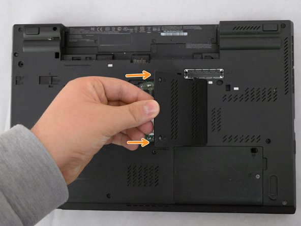

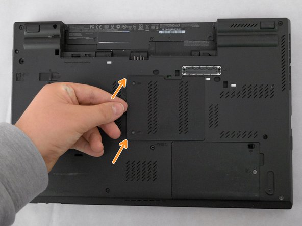

  5. Lenovo ThinkPad T530 Memory Module: Bottom Slot Replacement, Remove Rear Memory Cover: crwdns2935265:05crwdnd2935265:01crwdnd2935265:03crwdne2935265:0 Lenovo ThinkPad T530 Memory Module: Bottom Slot Replacement, Remove Rear Memory Cover: crwdns2935265:05crwdnd2935265:02crwdnd2935265:03crwdne2935265:0 Lenovo ThinkPad T530 Memory Module: Bottom Slot Replacement, Remove Rear Memory Cover: crwdns2935265:05crwdnd2935265:03crwdnd2935265:03crwdne2935265:0
    • Placing your finger below the indicated orange divot, pull the cover up and towards the CD/DVD tray.
    • Keep the rear memory slot in a safe place.

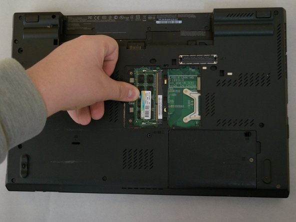

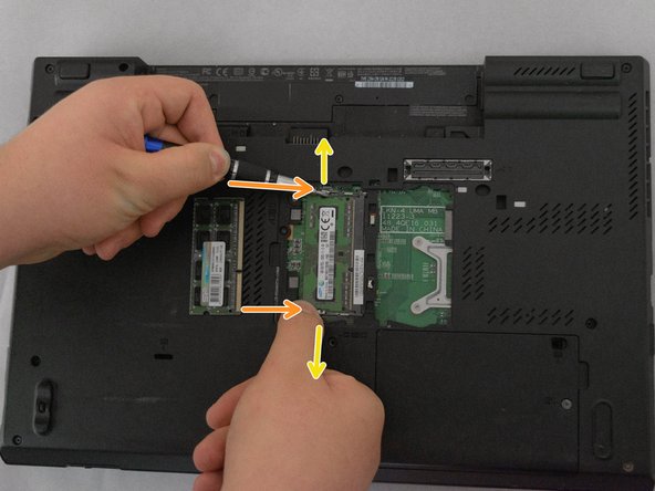

  6. Lenovo ThinkPad T530 Memory Module: Bottom Slot Replacement, Removing Existing Memory Module: crwdns2935265:06crwdnd2935265:01crwdnd2935265:02crwdne2935265:0 Lenovo ThinkPad T530 Memory Module: Bottom Slot Replacement, Removing Existing Memory Module: crwdns2935265:06crwdnd2935265:02crwdnd2935265:02crwdne2935265:0
    • None of the following instructions should require an exuberant amount of force, using an excessive amount of force may result in damaging your device.
    • The memory module is visible, but we first need to unlock the module from it's clips.
    • On the top and bottom end of the memory module, there are two latches. Put your fingers on the inside of the two latches, then push the latches away (towards the battery, and the trackpad, respectively).
    • Lift the module to a 45° angle, and then pull it out of the slot.
    • Be cautious, the memory module may eject from the slot.

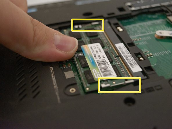

  7. Lenovo ThinkPad T530 Memory Module: Bottom Slot Replacement, Installing the memory module: crwdns2935265:07crwdnd2935265:01crwdnd2935265:03crwdne2935265:0 Lenovo ThinkPad T530 Memory Module: Bottom Slot Replacement, Installing the memory module: crwdns2935265:07crwdnd2935265:02crwdnd2935265:03crwdne2935265:0 Lenovo ThinkPad T530 Memory Module: Bottom Slot Replacement, Installing the memory module: crwdns2935265:07crwdnd2935265:03crwdnd2935265:03crwdne2935265:0
    • Insert the memory module at a 45° angle with the shorter notched end into the shorter connector.
    • Push the back of the memory module down until the two metal retention arms (highlighted in yellow) lock into place.
