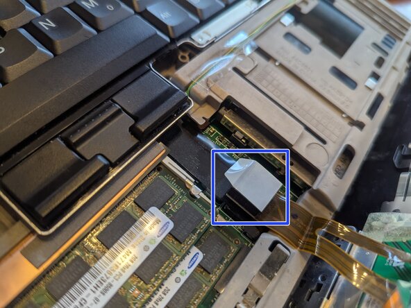

    • Remove the eight 14mm screws using the Phillips #0 Screwdriver.
  2. Lenovo ThinkPad T500 Keyboard Replacement: crwdns2935265:02crwdnd2935265:01crwdnd2935265:02crwdne2935265:0 Lenovo ThinkPad T500 Keyboard Replacement: crwdns2935265:02crwdnd2935265:02crwdnd2935265:02crwdne2935265:0
    • Lift the palm rest panel.
    • Lift the palm rest panel slowly; there is a ribbon cable connected under it.
    • The ribbon cable connecter is shown in the second image, circled in blue.
  3. Lenovo ThinkPad T500 Keyboard Replacement: crwdns2935265:03crwdnd2935265:01crwdnd2935265:02crwdne2935265:0 Lenovo ThinkPad T500 Keyboard Replacement: crwdns2935265:03crwdnd2935265:02crwdnd2935265:02crwdne2935265:0
    • While lifting the panel, lift the keyboard up.
    • Be sure to lift the keyboard slowly; there is a ribbon cable attached under it.
  4. Lenovo ThinkPad T500 Keyboard Replacement: crwdns2935265:04crwdnd2935265:01crwdnd2935265:01crwdne2935265:0
    • Use the spudger to disconnect the ribbon cable.
  5. Lenovo ThinkPad T500 Keyboard Replacement: crwdns2935265:05crwdnd2935265:01crwdnd2935265:01crwdne2935265:0
    • Remove the keyboard.
