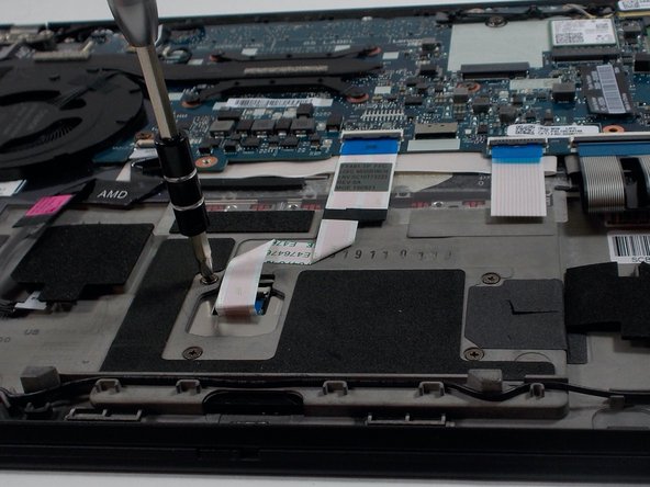

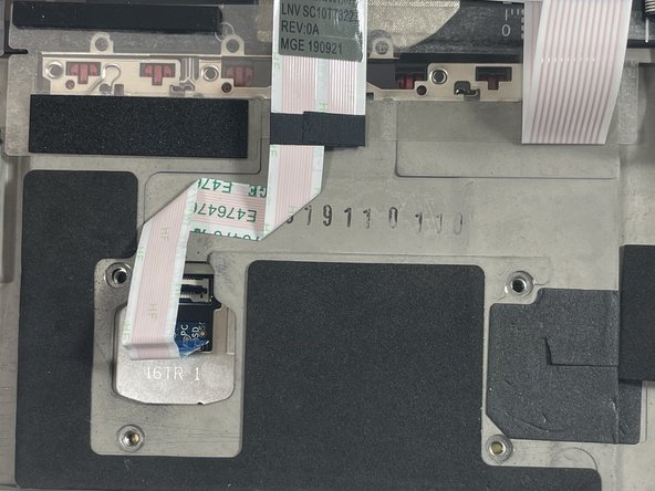

  5. Lenovo ThinkPad T495s Trackpad Replacement, Trackpad: crwdns2935265:05crwdnd2935265:01crwdnd2935265:03crwdne2935265:0 Lenovo ThinkPad T495s Trackpad Replacement, Trackpad: crwdns2935265:05crwdnd2935265:02crwdnd2935265:03crwdne2935265:0 Lenovo ThinkPad T495s Trackpad Replacement, Trackpad: crwdns2935265:05crwdnd2935265:03crwdnd2935265:03crwdne2935265:0
    • Use the iFixit Opening Tool to flip up the small locking flap on the trackpad's one ZIF ribbon cable connection. The ribbon cable should easily release from its socket.
    • ZIF stands for Zero Insertion Force; if you're experiencing any resistance whatsoever during disconnection, double-check that the locking flaps are flipped up.
  6. Lenovo ThinkPad T495s Trackpad Replacement: crwdns2935265:06crwdnd2935265:01crwdnd2935265:03crwdne2935265:0 Lenovo ThinkPad T495s Trackpad Replacement: crwdns2935265:06crwdnd2935265:02crwdnd2935265:03crwdne2935265:0 Lenovo ThinkPad T495s Trackpad Replacement: crwdns2935265:06crwdnd2935265:03crwdnd2935265:03crwdne2935265:0
    • Use a Phillips #1 screwdriver to remove the four 2.2 mm screws from the trackpad.
  7. Lenovo ThinkPad T495s Trackpad Replacement: crwdns2935265:07crwdnd2935265:01crwdnd2935265:03crwdne2935265:0 Lenovo ThinkPad T495s Trackpad Replacement: crwdns2935265:07crwdnd2935265:02crwdnd2935265:03crwdne2935265:0 Lenovo ThinkPad T495s Trackpad Replacement: crwdns2935265:07crwdnd2935265:03crwdnd2935265:03crwdne2935265:0
    • With the bottom of the laptop facing you, gently lift the laptop open until the trackpad drops out.
