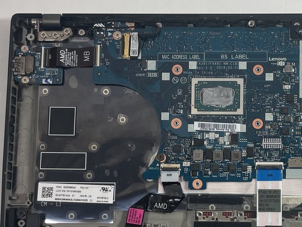

  3. Lenovo ThinkPad T495s Fan Replacement, Fan: crwdns2935265:03crwdnd2935265:01crwdnd2935265:03crwdne2935265:0 Lenovo ThinkPad T495s Fan Replacement, Fan: crwdns2935265:03crwdnd2935265:02crwdnd2935265:03crwdne2935265:0 Lenovo ThinkPad T495s Fan Replacement, Fan: crwdns2935265:03crwdnd2935265:03crwdnd2935265:03crwdne2935265:0
    • Use a Phillips #1 screwdriver to loosen the four 2.2 mm captive screws from the fan assembly.
    • The screws should stay attached to the fan during removal.
    • Use tweezers to unplug the fan assembly from the motherboard.
    • Lift the fan from the laptop using your hands.
